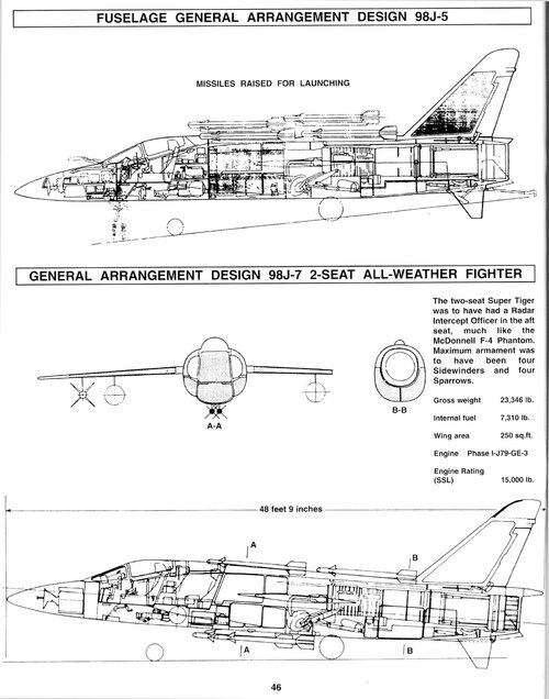

IF you can find a copy of "Naval fighters #44" it gives great detail on the SuperTiger... fun fact it was the first area rule aircraft in US inventory. EDIT for clarification.. the base Tiger was the first area rule...
There is a good sized section of the aforementioned about the various near sales. I don't think the site will allow me to attach a 29 meg PDF or I would just put a copy up.

ok now I am curious as to what an "F-11G" would look like... Landing gear and airframe strength are already sufficient, as are internal fuel capacity given what they did to the 104 to bring it inline to the mission profile, even the ejection seat fires in the right direction; so in theory you could get away with just plugging in the avionics!
As I understand it the Germans had an existing production license for the Avon and an existing maintenance infrastructure for that engine, so lets use that to keep program costs low. A reheated 200 series would be roughly what was put in the Saab Lansen and Draken, so will use the figures for the Lansen: That takes static dry thrust to 11,000 pounds up from 9300(some list it at 10,750 either way a nice increase), and AB is essentially unchanged at about 14,500. A nice increase in acceleration and the possibility of a cruise speed of Mach one or a little above.
That would be fine, but we all know there are going to be some "tweaks", there are always "tweaks".
Though BLC is not likely to be needed lets install it just for giggles... that takes the F-11 POA speed from 139 knots down to about 124 and her touchdown speed from about 110 knots down to 95 or so. Short field and STOL performance should be outstanding for the era. This should be considered the baseline "low cost" version.
Now if you want to get a bit more ambitious you go with a version of the 98J-7 2 seater but replace the RIO with electronics, relocating the cannon(should have space for a pair of 30MM or a Vulcan), and some additional fuel to offset the Avon's slightly higher SFC in comparison to the J-79. If you go this route you can relocate the electronic "bullet" for the APQ-50 to here and make room for a larger dish in the nose or you can leave it as is and have room for more toys.
This would be the high cost option with the greatest versatility and capability, relocating the "dustbin/bullet" and larger dish would allow you to parallel the upgrade path of the F-4's avionics and capabilities over time to a large degree.
They might go with a compromise between the two with a smaller "plug" in the fuselage to accommodate relocation of the cannon and some additional electronics... IDK.
One thing is it would be a serious giggle if the German navy bought them and decided to carrier qualify their pilots to increase interoperability with their NATO partners...results should be good and would probably lead to some questions being asked in London and DC.
