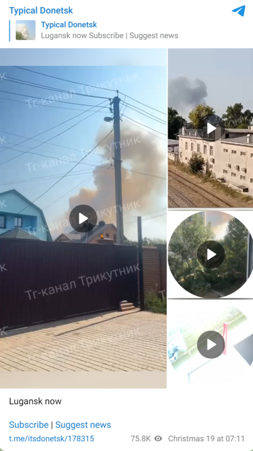

Wreckage of an ATACMS missile in the vicinity of Lugansk airport as reported by Russian websites. Russian sources claim that three ATACMS were intercepted in total.
Source: https://ria.ru/20240719/lugansk-1960640369.html
LOL That's the spent booster with a nozzle sitting next to it. The payload already deployed. I can't believe they keep trying to sell these as kills.
