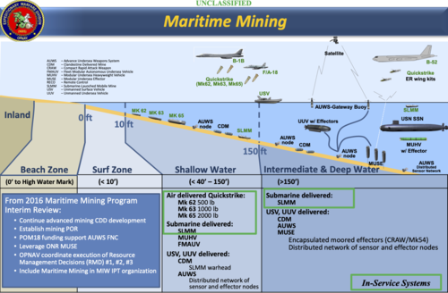

Well here's a slide on minelaying from Maj. General Owens USMC. So we're back on topic.
  • mining-owens.pdf
