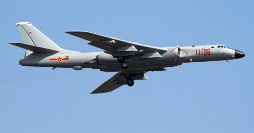

However, the first practical airborne DEW is likely to be a defensive weapon (range) on a large aircraft (power). It will be a bit of a shock to everyone's system....
....particularly if said large aircraft is one of these.
