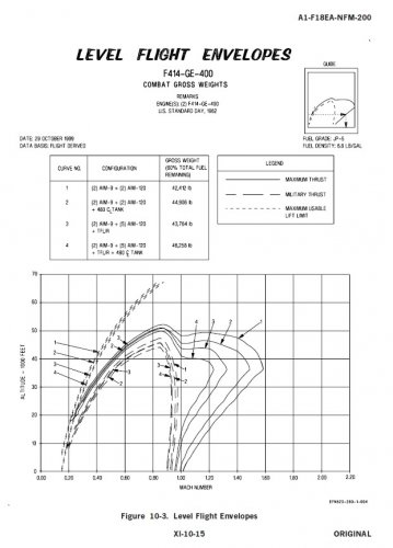

Here is an energy chart for the Superhornet that shows that it is actually slower than the F-35 while similarly armed.
