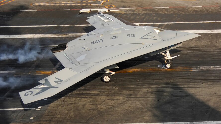

Any idea how the NG X-47B faired by comparison? Were one to blow the dust off something that would seem to be the obvious choice.
I doubt you can get affordability from legacy stealth prototypes.
It seems LM already tried.
Let's not compare apples and oranges. The X-47B & Phantom Ray are in a completely different class than something like the XQ-58 Valkyrie. They're more like an MQ-25 but for attack instead of tanking.
sferrin, I overlooked the X-47B, could also be a candidate for CCA Increment II. I assume the various CCA missions and CONOPS are going to drive size, range, payload, etc. I also assume any air vehicle concept or type would and could be possible depending on the mission scenarios.
What requirements for Increment 2 of the CCA drive us towards an X-45/47 class of AVs? Do we have firm indications of those from the AF at this point?
I don't know, my post is making assumptions, I am not a USAF CCA mission planner. I don't think anyone knows outside of the program what air vehicle type CCA Increment II is planning for. I look at the platform type and it's potential capabilities.
As far as I know we do not even have the Incr1 requirements in open source. I think he was just noting it was another established UCAV platform that could be produced off the shelf, if it fit the requirements.
Since Incr1 seems completely A2A oriented and focused on low cost over capability, I suspect nothing like X47 is adopted. Furthermore the USN seems just as focused on short lifespan UCAVs, so I cannot imagine they dig up the design either.
Someone should look up the cost of MQ-25 ;)
For sure but you wouldn't necessarily use something like an X-47B for a mission an XQ-58 could fill. But an XQ-58 won't be able to do everything an X-47B could do. If you want to drop 2,000 pounds of drone swarms ten miles from the target area a thousand miles away. . .
