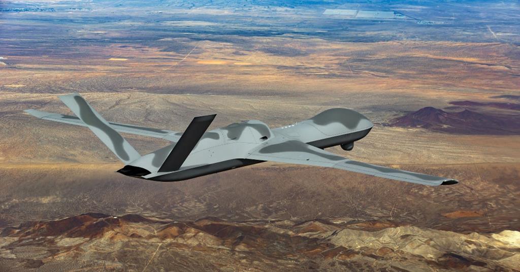

We know from GA and Andruil that their aircraft don't have any significant quantity of composites, they are very much traditional bended metal aircraft which would lead to likely higher RCS values than a traditional manned fighter which has both composites and additional RAM treatments. Whether we want to class something as LO or VLO or non LO becomes an academic debate on values and ranges and suspected treatments.
