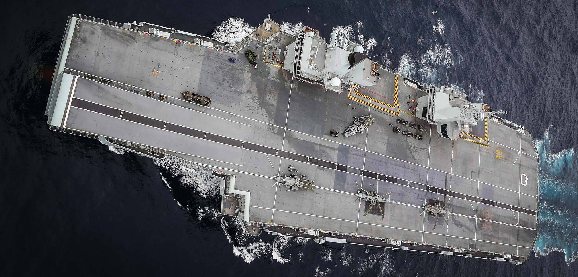

Is a new French carrier going to be longer than QE which is itself almost 50m shorter than a Nimitz?
