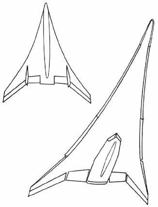

Yep, they did fairly extended studies at least thrice. First was in response to the SR-169 in 1958. Second, it was in 1962 bidding for the NASA SCAT studies (they lost, the awards went to Boeing and Lockheed, other losers were NAA and GD). Third, it was in the running-up to the formal 1964 competition. This is the best known effort, Model 2229, illustrated here in this thread. In August 1963 Douglas decided anyway to not participate to the competition.

Which one ? Ithacus ? No, originally it was (the original idea was earlier, late '50s, Scott has some material on that), but it hit the second-half of '60s starvation of funds regarding manned space projects. By '68 the NASA budget was barely supporting Apollo and a minimal follow-on program. As for the military budget, apart strategic systems (and after the traumas of Dyna Soar and MOL/KH-10), the conventional part of the budget was dominated by contingency (Vietnam). Moreover, the all concept of troop-carrying rockets is the extreme derivative of the "air transportable army" concept developed in second part of '50 by military men like Gavin and Taylor (all former paratroopers, BTW), that gave birth, among other things, to the Pentomic structure for the infantry divisions, but we are now veering seriously OT (and I fear the wrath of gods... :D ).
As for the Douglas SSTs, the company itself didn't believe in them in first place. The changed their mind in '70s and 80s, but that is another story (and thread).

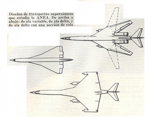

From "Mecanica Popular" January 1960 & September 1963
Post-3

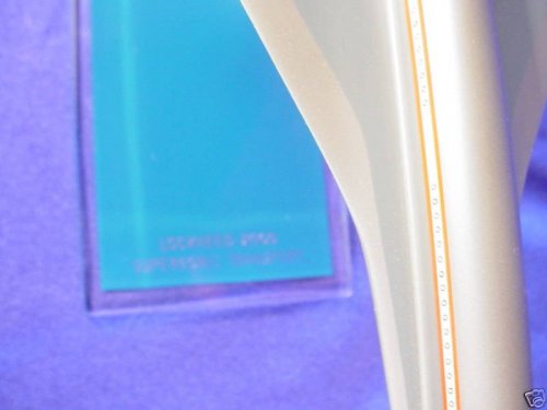

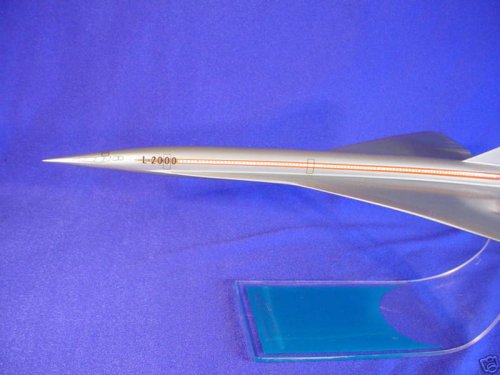

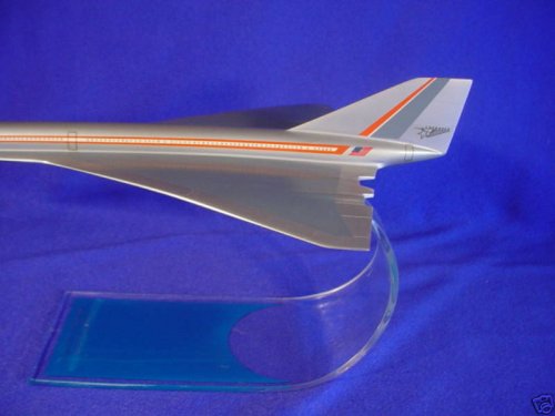

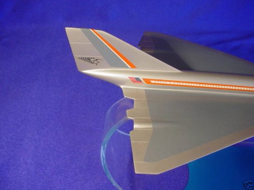

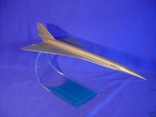

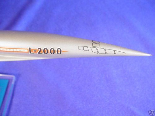

Oh! It's Lockheed L2000-1 offered for PHASE ⅡA study in Nobember 1964. Very precise model!

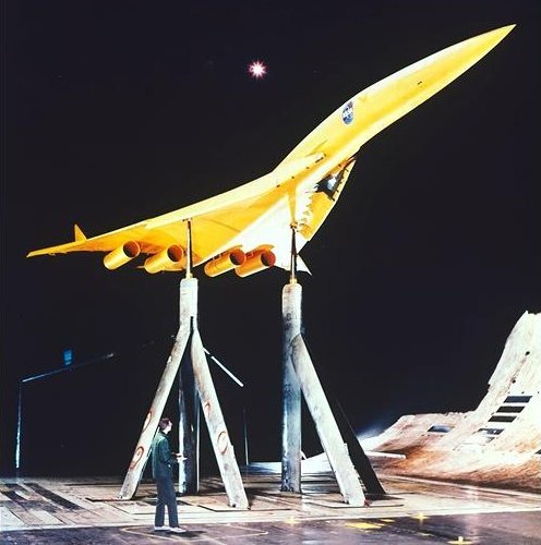

Please enjoy beautiful NASA SCAT-15F wind tunnel test model.

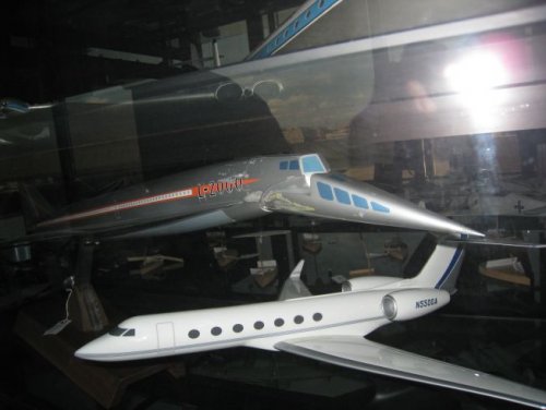

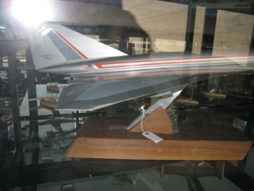

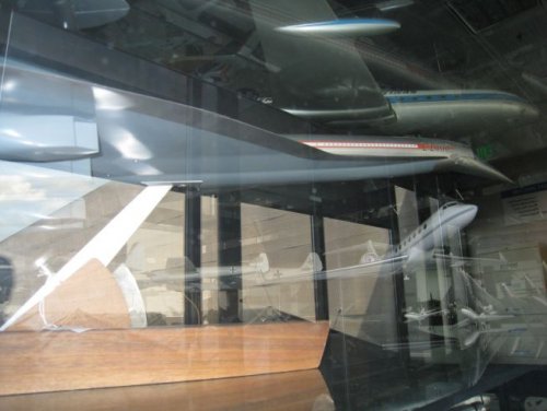

NASM has two very large (3 foot+) L-2000 models on "display" in a glass case in a non-public area upstairs. Due to the tightly packed nature of the case and the lighting conditions, I had a hell of a time taking photos...

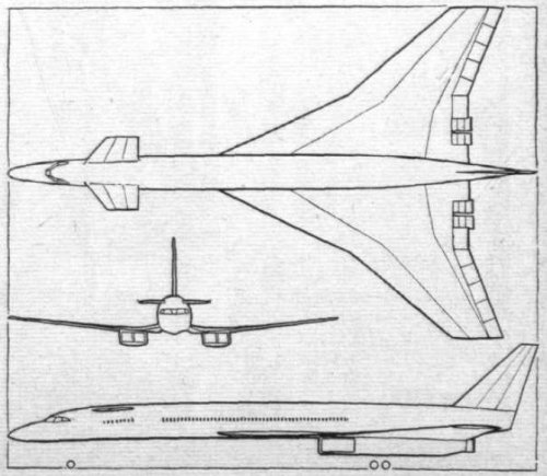

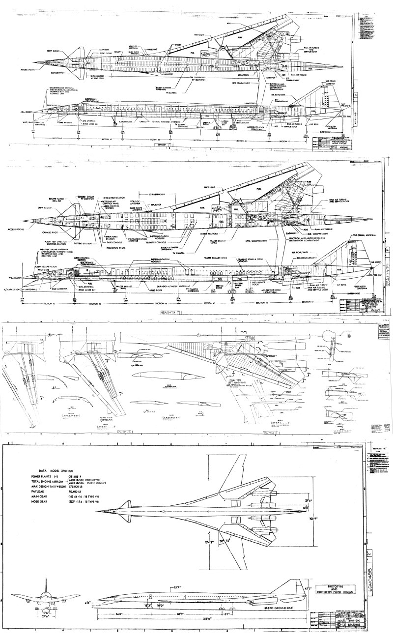

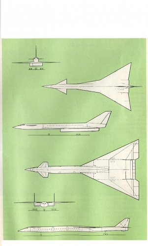

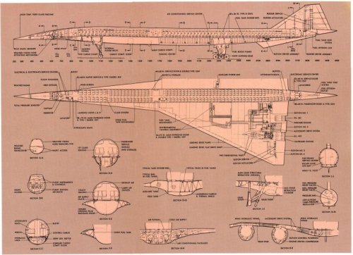

I never saw such a detail general arrangement drawings of B2707-200! It's historically very important. Also L2000-7, please.
Many thanks again Scott! Very beautiful pictures & drawing. But I believe this 3 side drawing is not represent final configuration of L2000-7A as you already knew. Final configuration had extended engine nozzle which end was go through the wing tailing edge as the picture clearly shows. We never see final 3 side drawings of L200-7A till today. It's very strange for me. Don't you think so?

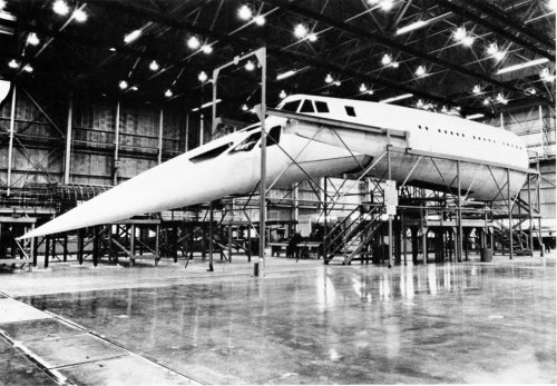

2707-200 fuselage nose section full-scale mock-up. Nose section was thought to be built by Northrop
from 'Northrop: An Aeronautical History'
