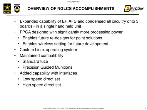

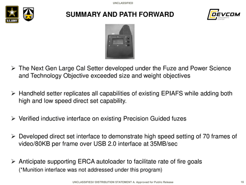

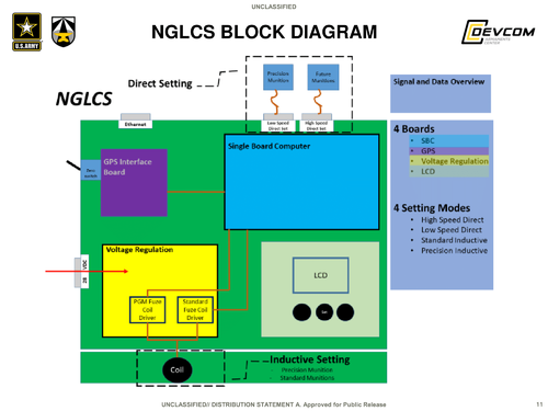

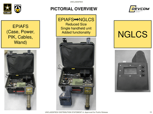

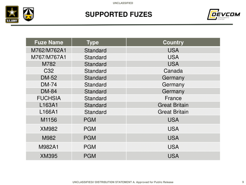

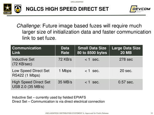

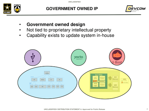

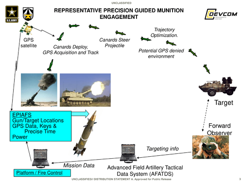

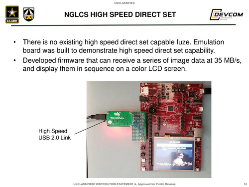

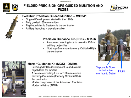

The question of fuzing of the modern rounds came up. Thankfully, vFuze 2020 had an answer.
That imagery transfer to the projectile (nav and terminal?) is motivating data rates higher than
inductive fuzing can achieve is interesting.

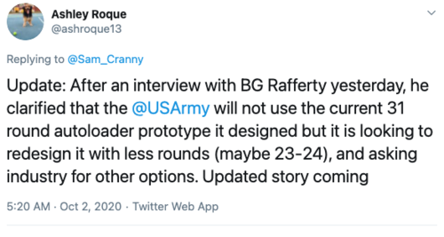

Weight and mobility challenges have forced the US Army to abandon a government-designed autoloader for its Extended Range Cannon Artillery (ERCA) programme and the service is now looking for help from six tech companies.
“The integration challenge for [it] was too much of a trade with mobility and durability, and some of the results from putting 3,000 miles on a combat vehicle [out at Yuma Proving Ground] weighted up with the centre of gravity issue that we had,”

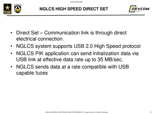

The inductive fuze setter they had would be the bottleneck for the rate of fire they want.
Not sure if I posted it in this thread, but the Army future fuze setters look to be direct connect
(USB 2.0) to handle the large data sets that have to be moved to the shell.
