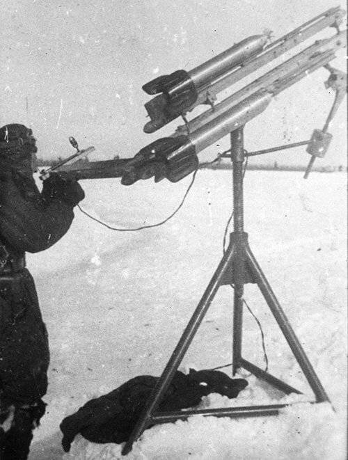

Whilst reading about bomb disposal in Second World War Malta, I came across an account of an unguided, ground-launched, anti-aircraft weapon used by the Royal Navy to defend harbour installations, which were frequently attacked at low or medium level by both dive and level bombing. Such a weapon does not really get any mention in accounts from the time period, and it is my first encounter with an account of such a weapon in the Maltese islands. Lieutenant Carroll was the leader of the bomb disposal section on the Maltese islands and had been present on the island from April 1941. He found this weapon at the entrance of capital, near the then-intact Opera House.

I am unsure as to what the weapon is for the most part, I've asked some fellow researchers who have a greater understanding of these weapons and they believe that it is either a 3" or 7" unrotated projectile. The use of such a weapon in such a densely populated and small area is quite astonishing to me, especially when considering density of both the civil and military population in this area.

A 1lb can makes me think 3" UP.
I would say almost certainly a 3in UP.
Could be in its Z Battery form or in the 2 round or 9 round launchers which were both sent to 'North Africa' for harbour defence. Could even be a shipborne UP battery that was landed from a ship when the order to remove was given.

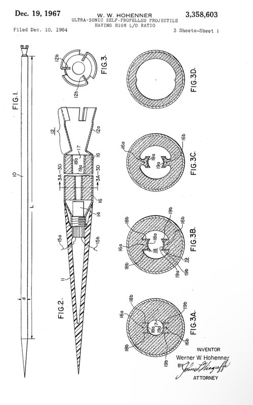

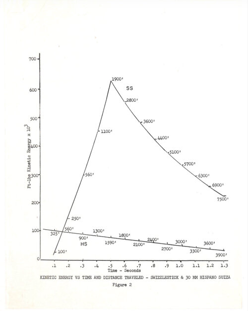

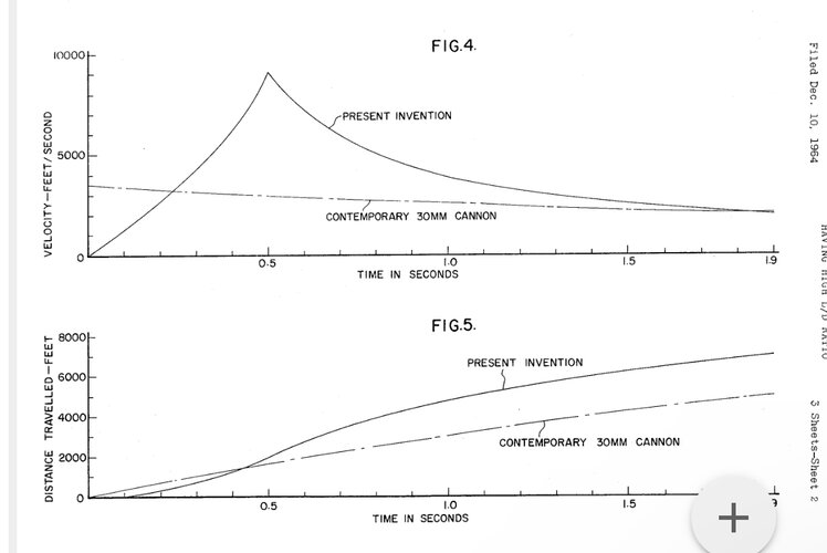

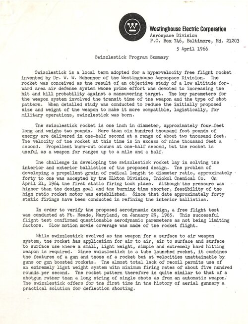

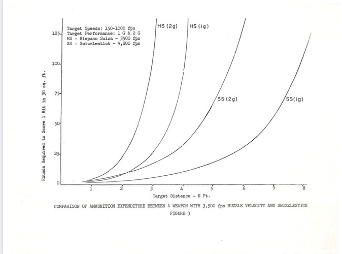

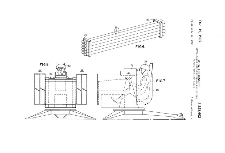

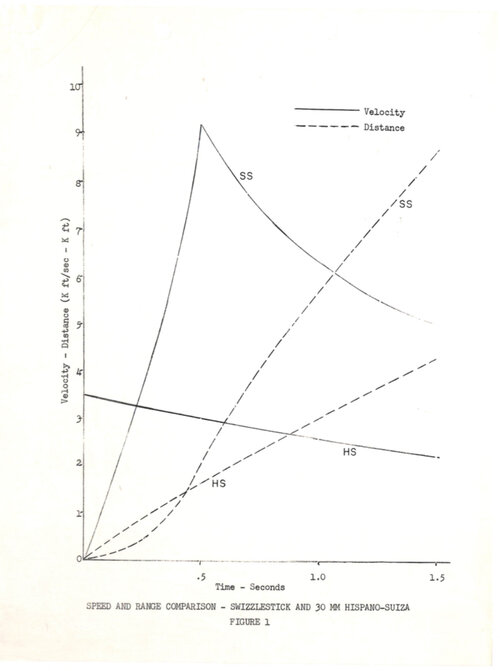

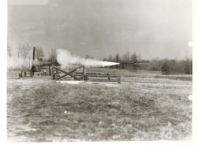

Well I did some digging with the National Archives and purchased a copy of the Patent Case file and found out this design was actually made and tested in the 1960 with a velocity over 7,000 FPS

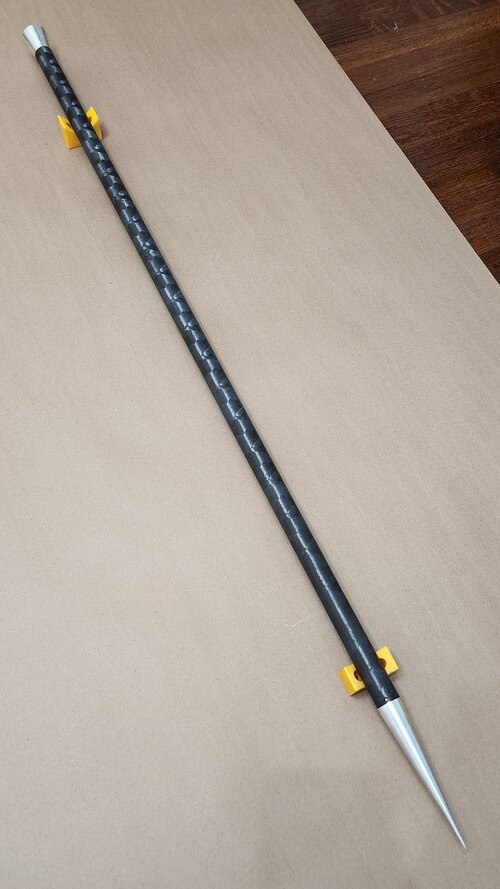

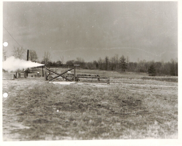

Theses photos have not been published online from what I’ve seen IMG_6775.jpeg
as far as the range of these missiles, what speed they reach and what their weight was ?They are similar to some German anti-aircraft system from WWII
