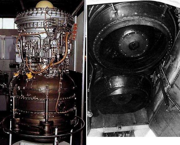

To add to what Spud has said:
kcran567 said:
the lift fan partly borrowed/bought from Yakovlev.
The Yak-141 doesn't use a lift fan
Separate engines. No lift fan or clutch or anything. This is another one of those internet falsehoods that doesn't stand up to even basic scrutiny, yet persists.
Grossly simplifying what is trying to be accomplished by the F-35 and then complaining about its price without comparisons and context won't help you understand the F-35 or any other high end military tech for that matter.
Also, the Yak-141 is strikingly similar to some of the old sea-control concepts from the 1970s.
