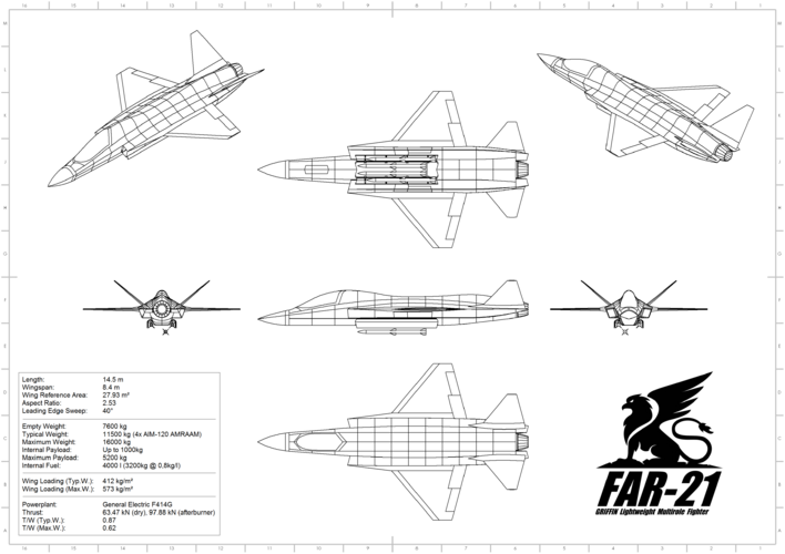

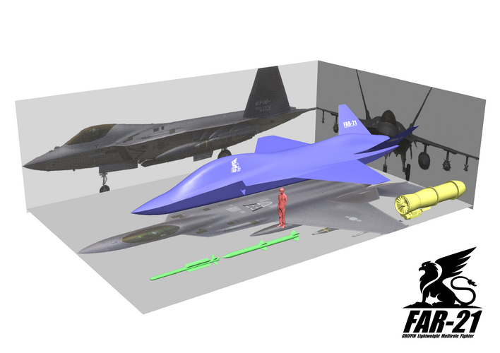

FAR-21 may fit your description...
https://www.secretprojects.co.uk/th...ultirole-fighter-lmf.38539/page-4#post-511614
Yes, or something even more compact which should be possible with today's miniaturisation of the components. Most important would be a real STOL capability (the whole system is no good if you can't get it in the air; VTOL may be too complex and expensive) and a fast deployability overv the whole country.

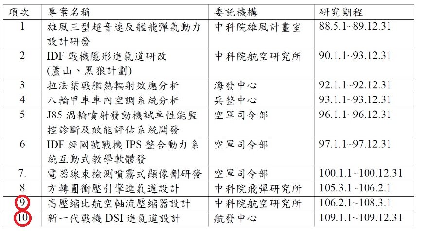

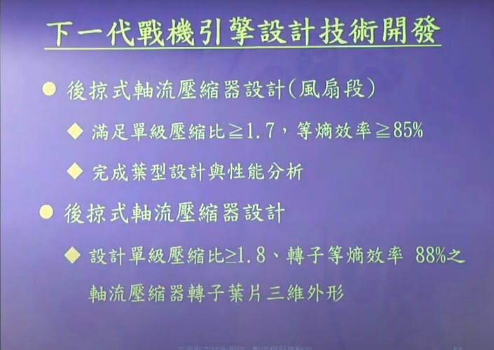

Development of next generation fighter engine design technology
●Design of Swept-back fan stage
→Satisfy single stage compression ratio≥1.7, isentropic efficiency≥85%
●Design of Swept-back axial compressor
→Design three-dimensional shape of rotor blade which single stage compression ratio≥1.8, isentropic efficiency=88%
