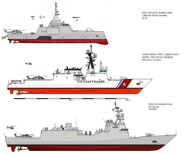

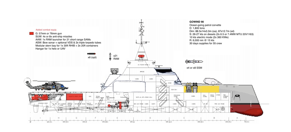

Sounds similar to my 1,800ton / 290ft Patrol Corvette concept.
This was basically my attempt to take a proven OPV design (Gowind 87m / 1,500 tons), adding stealthy superstructures, a corvette weapons fit and more powerful engines. Hard to go much smaller if you want true blue water capability and range.
I've seen a sketch concept published by Naval Group that looks a lot like this, so I believe it's feasible. The result is actually quite similar to a German K130, but with longer legs and better seakeeping.
D: 1,800 tons
Dim: 88.5 x 14 x 3.3m (overall), 87 x 12.7m (waterline)
S: 26-27 kts on diesels (2x 6.5 or 7.4MW MTU 20V1163)
10 kts electric mode (2x 360 KWe)
R: 6,000 nm @ 15 kts
Crew: 55 pax / 30 days supply
Guns: 1x 57mm or 76mm main gun, 2x 30x113mm Bushmaster
SUW: 4x or 8x anti-ship missiles
AAW: 1x RAM launcher (21x SAMs)
ASW: Bow sonar + optional VDS & 2x triple torpedo tubes on flight deck
Modular stern bay for 1 or 2x 30ft RHIBs/USVs + 2x 20ft containers
Hangar for 1x helo or 2x UAVs

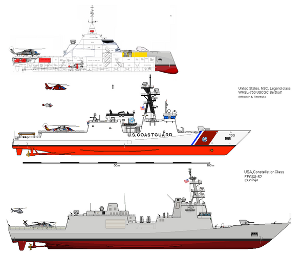

Here's a comparison to an NSC cutter and FFG-62:
D: 1,800 tons
@ H_K
I think I’ve seen your posts in the extensive TapaTalk ‘Design a Corvette’ thread. Great conversation there & solid points made by you.
Is your Gowind design using the shortest hull but with the displacement of the mid-range version? I have trouble mentally squeezing 6,000 nm out of that arrangement if the original Gowind ranged ~3,700nm. If you lengthen the hull to 100+ meters, then you’d be closer to a 6k range, no?
Everytime I run numbers and draw stuff, I revert back to the US just needing bigger ships for everything, based on USN standards, our range needs, and the fact that I can’t stop trying to squeeze in a 16-ton 8-cell Mk.41 VLS to permit the skipper to threaten long distance drones & patrol plane snoopers w/ESSMs, and add to the AAW magazine in general.
My starting point is the 1,500 ton / 87m Gowind OPV design (formerly “l’Adroit” now Bouchard class in Argentinian service). These have a fairly generous fuel capacity of 250m3 (210 tons) which allows for a range of over 8,000 nm @ 12 knots
This translates to roughly ~6,000nm @ 15 knots, 4,700nm @ 18 knots, or ~4,000nm @ 20 knots.
I’m assuming a small increase in displacement (slightly increased beam at the waterline and longer bow forward, to improve seakeeping and top end speed) which wouldn’t impact range as this also allows for more fuel tankage.
Though notably not in 127mm.
Or USN finally gives up on 127mm and steps up to 155mm/L52 NATO-standard. Do like the ERCA, pack the Charge Super into a brass or composite case that is roughly the length of your standard 155mm shell and do two loading ops per firing cycle.
And punt the things out at whatever the fastest MV that copper driving bands can tolerate for ammo compatibility.
It seems extremely clear there is no 155mm on the horizon. There won’t even be a potential platform for it outside DDGX, and the USN has zero interest in new calibers. 57mm and 127mm or nothing.
D: 1,800 tons
For what it's worth, here's a cleaned up view of my 1,800 ton patrol corvette concept and comparison to NSC and FFG-62: USN 1800t patrol corvette 2px=1ft v2.png
