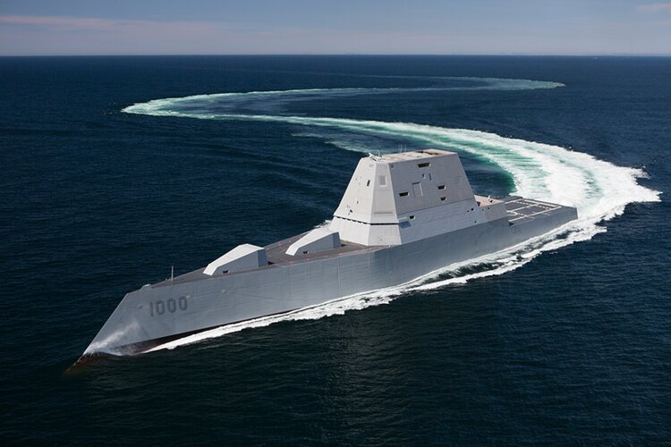

I am intrigued to see what is done fitted VPMs to the DDG 1000s for hypersonic missiles. Will the design solution be suitable to incorporate into DDGs and FFGs as well?
Definitely not. The CPS missiles are too long; the launch tubes would require another deck's worth of penetration compared to the Mk41s.

A shame the USN can't be bothered to go with the most obvious solution:
They are doing this. CPS is in fact going on the Zumwalt's, assuming the program continues as currently planned.
I meant going forward. Hopefully the Tico replacement, if it ever gets built, will be large enough to not have to resort to giant deckhouses to include CPS. (Still sore about them shorting the Zumwalt line and creating a giant CF.)

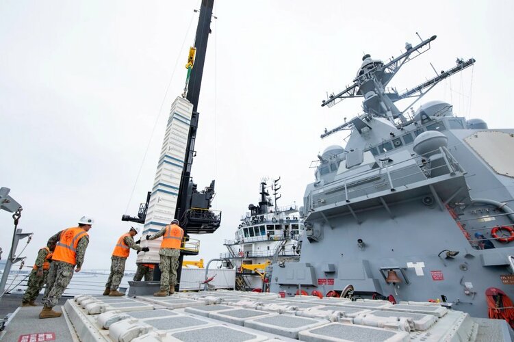

I'd assumed they could already do that. I knew they'd removed the VLS integral cranes but I'd assumed they could at least reload from supply ships. They've been doing that with SLBMs since the 60s.
Nope, they abandoned in the 1990s all attempts at providing a reloading at sea capability for USN VLS ships as too difficult and expensive, and anyhow totally unnecessary in the new age of enteral peace. [sarc]
They can and do reload from tenders, this isn't a demonstration about the act of reloading it's a demonstration of reloading from this particular type of vessel.
The USN haven't reloaded VLS ships at sea or indeed outside of ports and such since the late 1990s at least, so far as I am aware.
They abandoned it because it was extremely dangerous to perform at anything more than a glassy calm. Not only due to the possibility of a wayward canister striking crew or the ship, but also there was the possibility of damaging the weapon. Reloading at sea sounds like a wonderful idea until you crack a motor casing.
In practice, it wasn't a lost capability for the USN because the Mk13 and 26 launchers that the Mk 41 was replacing couldn't reload at sea either.
Then reload/rearm it in a bay? It's hardly rocket science, that's something the US did in WW2 as well.
It will still be useful to have a few combat cargo ships/maritime prepositioning ships loaded with wooden rounds, at least when the ports and warehouses necessary for this job have been destroyed by strategic bombardment, simply because there's more small bays and calm lagoons than military harbors in the world.
Even if they aren't destroyed, having a transit time of two or three days to some random island shoal beats a week back to Guam or a fortnight to Hawaii. Most of the reasoning for the reload at sea comes from the need to have more ammo in the theater (SCS) than the USN has VLS cells, either now or in the future.
It's a completely lost capability, and one that needs to be regained, because the USN isn't getting more big ships in the medium to long term future.

The fact that VLS require in-port, in calm water reloading is a stunning shortfall which needs refinement before someone else does. ...have to believe this is a cost issue not so much engineering. ..cant imagine how one survives as the 'porupine' w/o a quicker reload.
This is much less of an issue than it sounds like.
The amount of weapons the Navy has is roughly of the same magnitude as the amount of VLS cells they have, and that is probably more than what they'd need to fight any serious naval war. Underway replenishment is not a requirement for fighting a major war, because before you'd need to do it, you have either already won or lost all your ships. This is just the same calculus that said that you don't ever need more than 4 AShMs in any realistic situation against a peer opponent. Either you have sufficient numbers that you'll have taken out everything after firing 4 missiles, or the enemy has sufficient numbers that you get sunk before you get to fire more than 4 times. The Navy doubled that and made the requirement 8 just to be sure.
