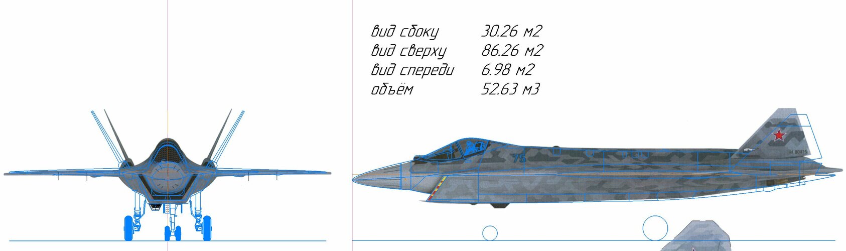

The engine went forward by 173 mm. The center of mass moved back by 526 mm. The wing area has grown from 60 m2 to 66.9 m2 (although I'm not sure I counted it correctly here). The area of the front view, and with it the midsection, decreased from 7.2 m2 to 6.98 m2. Taking into account the fact that the area of the top view has become larger, L/D has also increased from 11.7 to 12.36 (+5.7%)
The volume of the airframe has practically not changed 52.63 m3 versus 52.4 m3It is understandable, as the volume increases, so does the mass, and the engine has not grown yet. We need at least 20 tons on the afterburner.

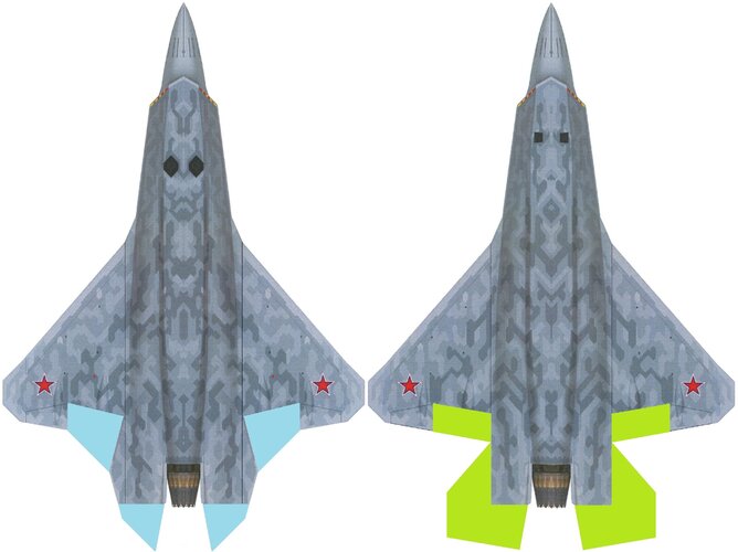

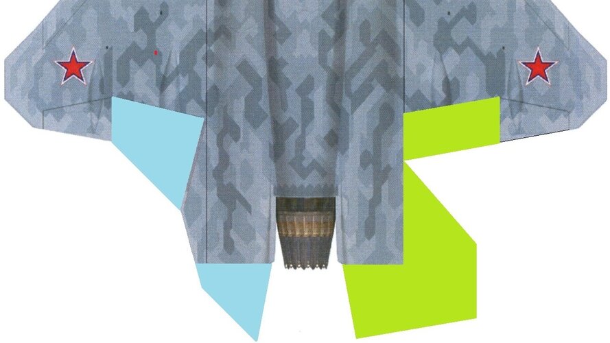

I wonder what may be the advantage of this unique control surface arrangement (blue) over the arrangement commonly used on combat aircraft (green)?
RCS, weight and cost, I suspect. But as Sundog says, it's entirely possible that it could end up with the more traditional configuration you suggest. Commonality-wise (which is probably a consideration they are not going to accept significant compromises on) this isn't really any worse - perhaps they could use a cropped version of the Su-57 h-stabs.

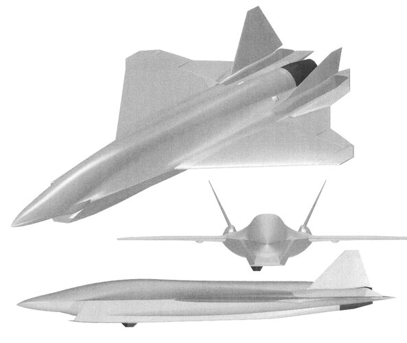

EDIT: I am reminded of this:
But, what are the benefits over a conventional layout like the one used for the su-57 less signature? Less drag? Does the patent states them?
It does but not in this patent. It's in the old layout's patent.
Nvm.. i posted wrong patent. lemme find the proper one first.

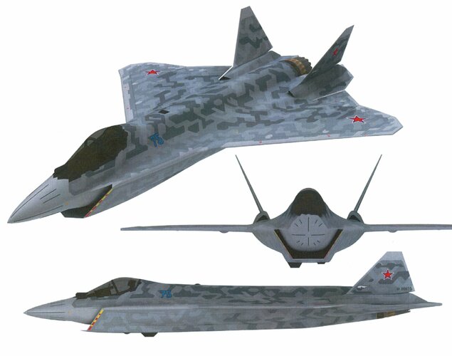

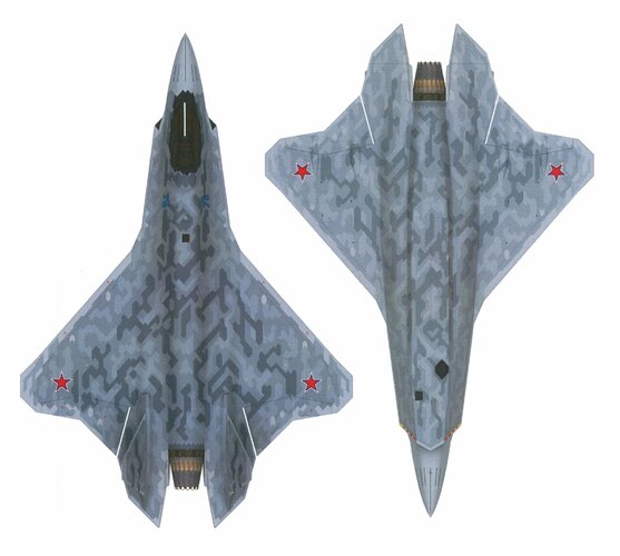

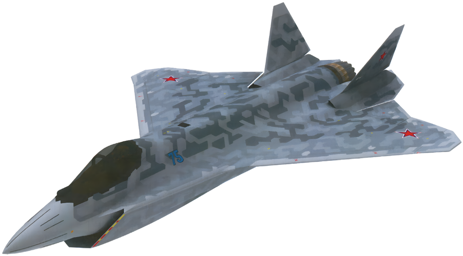

This one RU2770885 :
Mildly curious, with all those patents, which versions are to be prototyped(if they will), and in what order if yes.
While the hype carrier is the manned fighter, the other 2 are just as interesting.
Naturally they will start with single seat and 2-seater. UAV comes at last.
Also it could be safe to assume that the latest "frozen" design that will have flight prototype. At the current stage tho, as we see with the latest iteration, the design of the LTS is not frozen yet. Thus both patent may ended up the way it is, while the real flying prototype could be well different to the patent.
I did think the other day that the Su-75 was possibly an even better application for the 2D nozzle recently revealed than the Su-57. No possibility of roll TVC with a single engine anyway, and the relatively buried installation seems to preclude yaw vectoring too. Might as well go for a stealthier 2D nozzle with a single axis of movement.
