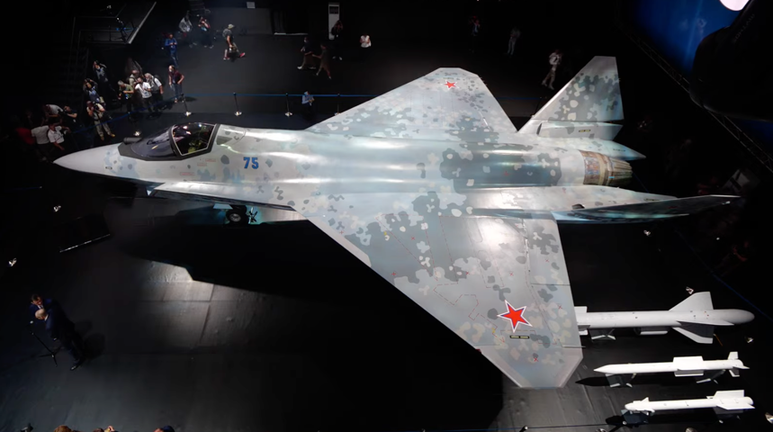

So we know what it looks like, hurrah ! My first impression: the bastard child of the two losing JAST / JSF concepts.
- the "paper" one eliminated in '97( Bae / MDD, from memory) (rear end, twin fins)
- and of course Boeing X-32, for the intake
And there is a small "pylon" to link the intake to the cockpit / nose assembly (so my earlier fears were founded, somewhat :p )
I like this bird, really. Impressive !
It tickles me that they had to offset the nosewheel to the left to fit the underlying avionics/cooling for the EOTS off to the right. The engineers definitely earned their pay in trying hard to get everything into a tight package and they seemed to have made a good series of trade-offs to get this design.

On the outside it's not terribly impressive or inspiring (compared to the F-35)
If i may ask, 100% seriously: What so impressive and inspiring do you see in F-35?
As a huge fan of MiG-21, F-16 and other masse single-engine fighter-jets, i was inspired by JSF when it was presented for the first time, with declared price tag of $30 million in 1990's USD.
The front fuselage geometry and inlet are quite unique.
I'm tempted to add: "kudos, Sukhoi: you managed to make me love inverted-intake akin to the X-32". It was only a matter of putting a sleek Su-57 nose and cockpit above / inside it ! The combination of the two looks aggressive and sleek at the same time.
That damn think looks like a Mangaka wet dream, Area 88 except in the stealth era.

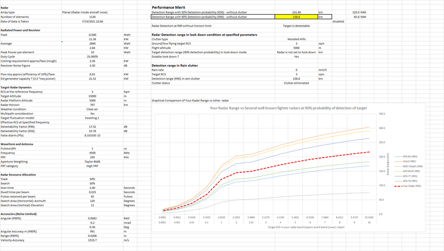

and well i guess it would be smaller cousin. Maybe 68 cm diameter aperture as Zhuk-ME. This can pack about 1100 Modules max. Based on that I have made a range estimate but very speculative.
Which resulted in range of 158 km with 90% detection probability against a 3sqm target.
Think it will be possible that they will give a T/R count on the AESA radar based on anyone's experience with maks airshows regarding the Su-57?
The nosecone size looks suspiciously Su-57 sized, if my eyes don't decieve me, so we might expect the same ~1500 T/R modules, but that also raises question of cooling capacity.
It was said that the radar could attack up to six aerial targets. Which would indicate Zhuk.

Like I am talking about 68 cm diameter antenna and if it being an AESA it can pack 1100 TRM. Not whether there is Zhuk radar inside Checkmate's Nose.

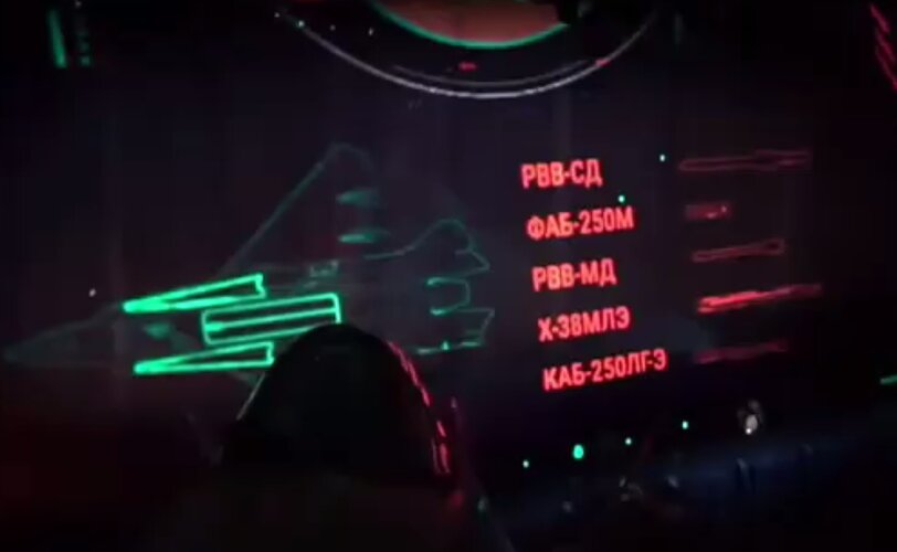

which means we should revise the Su-57 to possibly carrying 6xRVV-SD and possibly not entirely dismiss the possibility of eventual R-37/RVV-BD class missile integration in this airframe).
Not RVV-SD, but R-77M are carried internally. And it is long known that it will receive internally carried LRAAM, Izd.810.

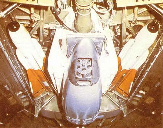

What I don't understand, why there is no on-board gun. I understand that this is just a static demonstrator and many things can change before production model, but in promo they stated it will have: in bay cannon containers
Is this could be something in style and form of gun mod they used on F-106 back in the day?

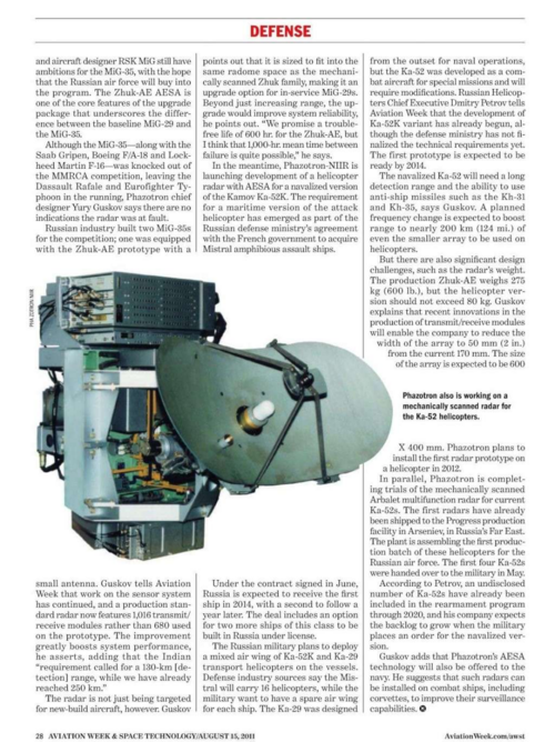

A 68cm antenna should be able to carry more than 1100 modules.
Are you OK ?
use a better comparison like the options I gave in radar detection, please/
What the hell. are you seriously understand what i am saying back in my post ?
I am not comparing things. I am guessing that it will have 68 Cm diameter antenna. NOT comparing radar. and that 68 cm diameter antenna can carry about 1100 modules.
I think he emant that Zhuk-AE with 1016 TR modules and diameter of ~680mm has claimed range of 250km.
However, the GSh-30-1 with its short barrel life and small ammunition load would seem unsuitable. Any thoughts?
Small ammunition load is problem of airframe, not cannon. Barrel life is problematic only with long bursts, which are, well, the case with ground pounding quite often, so... Might look somewhere else.
