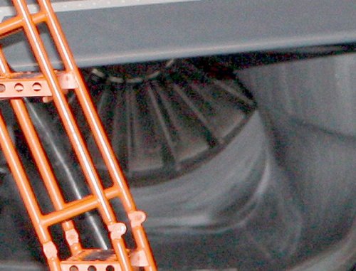

Looks like AL-31F compressor blades, not a radar blocker. Certainly interesting.

Hell, maybe they are going to use plasma shielding for the fan face. There's a U.S. patent online for just such a feature from 1974. Who knows? All I can say is, they'll have something obscuring the engine face from EM sources when it goes into production.

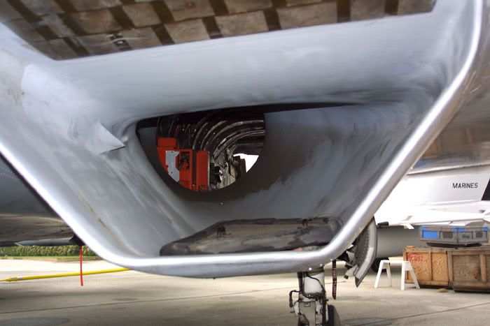

I'm surprised Sukhoi decided to plan for a blocker (because that's what we'll see in the finished article, even if there is none at the moment, or they would not have put as much effort into shaping) rather than curved ducts. After all, the latter were already demonstrated on the Su-47. Then again, the F-32 design (aimed at meeting the same LO criteria as the F-35!) seemed to get away with a blocker, so I think Abraham Gubler's assessment is not a foregone conclusion. Performance could be a concern, however I read workshare distribution list for the new engine which suggests RCS reduction is being tackled as part of engine development - so the blocker could be matched well to the powerplant.
F-32 had no other option, as the engine was ahead of the cg, with very short inlet duct. Rule of thumb for S-duct is length = 3-5 times engine face diameter, depending on how aggressive you are with turning of the flow. I don't know how good blockers are these days, but I doubt their pressure recovery penalty is lower than a nice curved duct. The aforementioned constraints dictated by legacy structural design is the likely justification for their use.

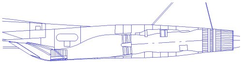

hmmm... so a bit of updating from the old one. . .

IIRC, the F-32 was to have a variable geometry fan blocker. But, I suspect pressure recovery won't be a problem if the inlet was designed to have it in place from the start. I could see if it was added as an after thought where that would be a problem. BTW, I don't know if the SH's fan blockers are fixed or VG. I assume fixed, but I don't know.

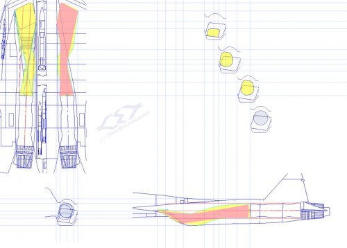

Nice and simple solution for radar blocking. I think that there are two blockers:

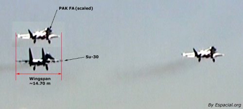

And this other picture about the wingspan of PAK FA (image taken from Sukhoi video):
