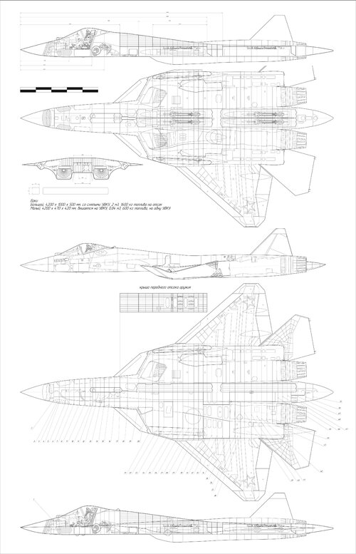

Err.... what happened to those central weapons bays tho??? The bay doors are shaped differently.

That is just a marketing stand by KTRVErr.... what happened to those central weapons bays tho??? The bay doors are shaped differently.

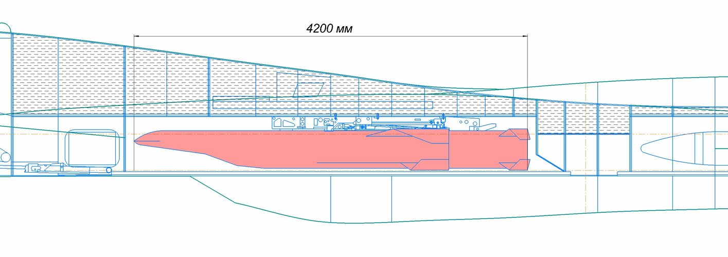

That has much more problems than just bay doors. This pseudoKAB in internal bay...That is just a marketing stand by KTRVErr.... what happened to those central weapons bays tho??? The bay doors are shaped differently.
"designer girl work"? Seriously?!? If you'd tried that argument around our female engineers you'd have finished the conversation flat on your back, and deservedly so.Guys, I think you're overthinking things. It's likely shoddy designer work, or as Runet saying goes - "designer girl" work.
Not only can't fit inside, this is oldest bloody KAB out there at all.I get that the KAB-500 is a tad on the impossible side...

At that size, its the same as an AARGM-ER.Carried internally. Looks to me like the diameter will be constrained to about 40 cm and length of about 4-4.2 meters.
Both HACM and Screaming arrow are supposed to be carried by tactical fighter such as F-18E/F, F-35 they must be much smaller than GZUR, GZUR probably similar size with Kh-22.HACM i cant tell if they do not show size differences like is it related to GZUR launched by a tu-160 or is HACM actually smaller than Larva-MD or at the same size? Screaming arrow gives us a size estimateBasically this is something similar to HACM and Screaming arrow?
