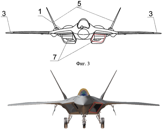

I am assuming the reason most assume izdelie 30 was considered variable cycle is that high bypass ratio engines were common for their 4th gens because of territory size meaning range over speed. But it seems they are keeping that advantage along with bumping up the thrust to the advantages of a low bypass engine. Trying to find the source of the official that stated fuel efficiency of AL-31F.
That variable bypass offers superior performance on paper is not being debated. I am questioning the assertion that the izdeliye 30 will be variable cycle; I haven’t seen this to be the case, and statements claiming this were usually made by journalists rather than from officials themselves.
I know no direct statement, but we know indeed it is not three streams. I said likely, so mine was no assertion. In the N+1 interview Marchukov was essentially saying the 5G engine is VCE, and izd. is considered 5.5G, so the hint is rather strong, more knowing the background of the research in YF120/izd. 20 by the end of last century. Then the provided engine performance is IMHO far from trivial with a fixed BPR. But as said, if any expert can enlighten us in that regard I would be a happy man, this is one the big remaining questions about PAK-FA.
I don’t see much benefit in the Su-57’s operating envelope. The airframe is designed with a maximum speed of about Mach 2, and like the F-22, mainly due to materials rather than drag limitations. A variable inlet’s benefit in this regime is marginal.
Well, I don't have access to the plane's requirements, but when the patent states an intake optimized for M = 2 to 3, I suspect maybe they do plan to go beyond 1.5 M. We know the F-22 max speed is also above 2 M. I would need to check, but I think that, in general, the fixed intakes are already starting to lose performance strongly from M 1.5 onwards.
30% bigger capture area? Source? In any case, large capture area tends to have little to do with supercruise performance and pertains more to low speed engine performance; large capture area can lead to increased spillage drag, since an engine “consumes” as much air as it needs; this can be mitigated to some extent by the variable ramps.
My own measurement with blueprints. To be honest, I am not sure anymore whether the exact value was 20 or 30%, but it was quite significant in any case. I would assume max thrust at very high altitude does require to maximize the airflow to the engine. I also assume there might be an element of growth reserve, specially if three streams engines are developed for the Su-57, which seems indeed in the plans from what we know about both the aircraft's and the izd. 30's development roadmap. These would greatly mitigate any possible spillage issues the oversized intakes may create with the first stage engine.

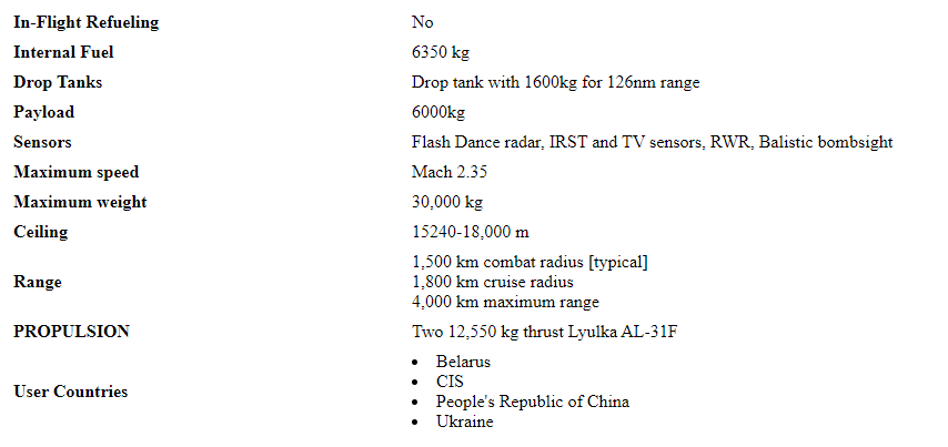

random google search gives me the Max weight on the Su-57 of 35,000kg and internal fuel of 10,300kg. Su-57 is a little heavier but has more internal fuel. Will the Su-57s max range be higher than the Su-27 along with the addition to supercruise? Trust me my curiosity for the F-22s ferry range on another thread was not of bad intention, I just love technology. :p

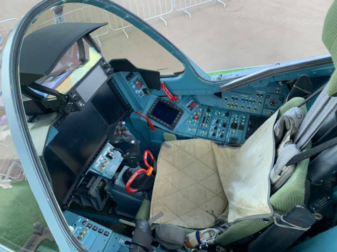

Still not sure as to the nature of the big top plate over the HUD though.
Is it some sort of sun shade or just some integral frame to support the big display plates? The first HUD did not have it and it seems a questionable addition to me.
Perhaps its a ground shade to protect the HUD from Sun and heat while its on the ground?
I like the Su-57 cockpit, clean modern and notice the distinct lack of switches due to the big multifunction display.
