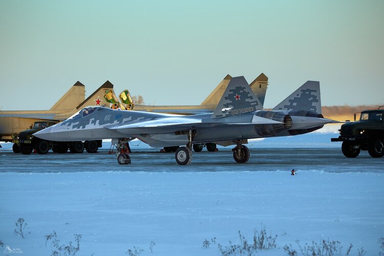

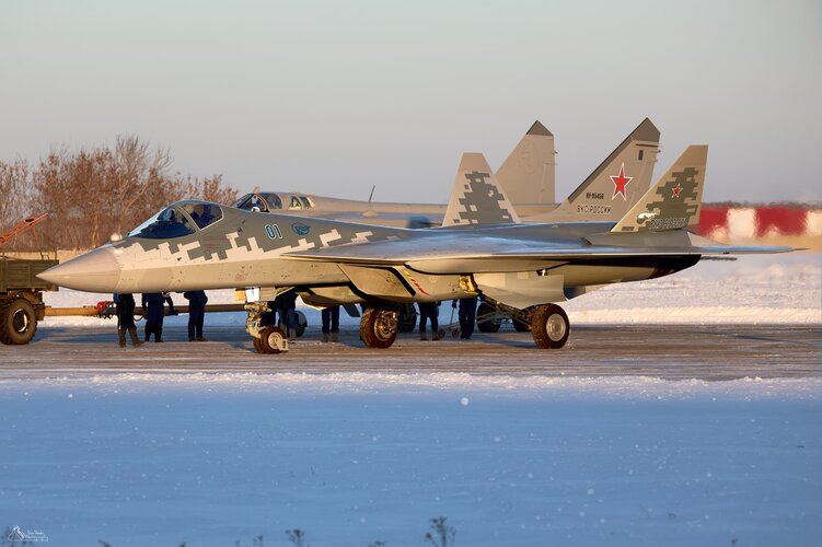

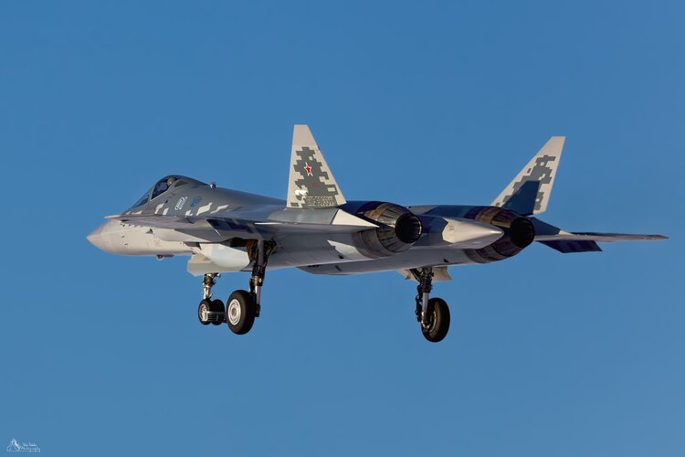

Well, it's only technically a serial and only technically delivered to the VKS. The blue logotype behind the bort number is that of the Chkalov state flight test center, it doesn't have the final engines or nozzles, some skin-related things aren't present, the OLS is still a placeholder (and probably several other electro-optical apertures aren't housed the way envisaged), and there are multiple other things that are subject to change still.
But it does show that they got the base manufacturing down properly. Huge, smooth composite panels cover the entire thing, it's just a huge step for Russian military aircraft manufacture, quite unlike the rather crude Soviet-reminiscent prototype series or the products of other Russian bureaus. Sukhoi is now miles ahead. Still, this aircraft isn't finished.
Will you pls be more specific as to what you meant by some skin related things aren't present , electro optical apertures aren't housed the way envisaged and multiple other things that are subject to change.
Will you pls briefly elaborate the skin related changes . And the apertures have always been housed in this fashion since the last few prototypes .

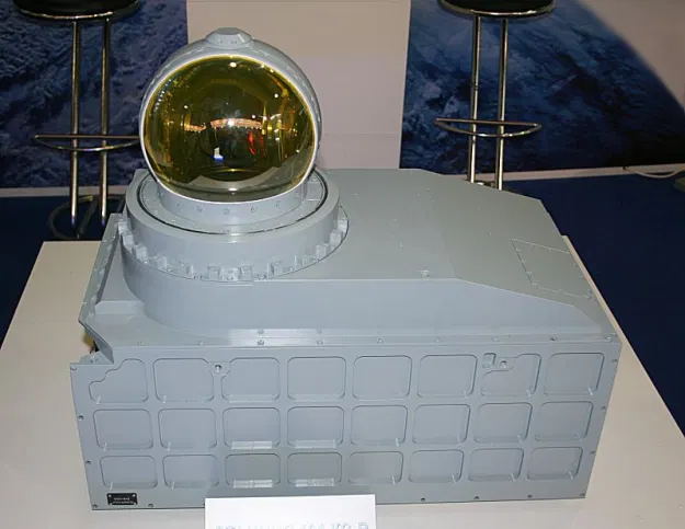

OLS turns around when not in use.
Like?
Why?
Which ones?
Like?
It has full set of expected changes in surface threatment it was expected to get. It has full set of 101KS systems, including 101KS-V OLS, 101KS-U MAWS, 101KS-O DIRCM, 101KS-P "landing assistance system"... There is nothing listed/expected/claimed to be a subject to change, let alone multiple things. Only properly mentioned thing is engines, and it was NEVER expected to go into serial with second stage engines from the get-go. How on earth it is "isn't finished"?

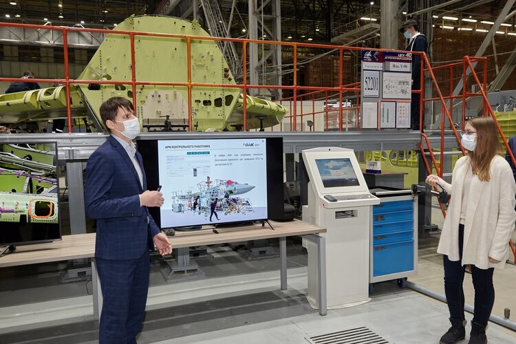

The winner of the youth competition "The Future of Aviation" held by PJSC UAC was the project of the branch of PJSC Sukhoi Company "KnAAZ im. Yu.A. Gagarin "Implementation of Augmented Reality in Aircraft Industry", presented by Lead Programmer Valery Timokhin, Software Engineers Roman Zalata and Valentina Nikitina.

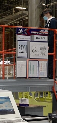

and serial number:52201

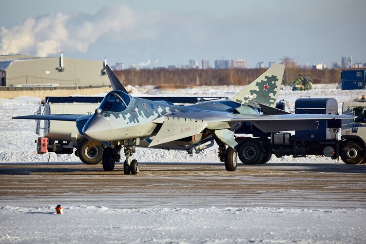

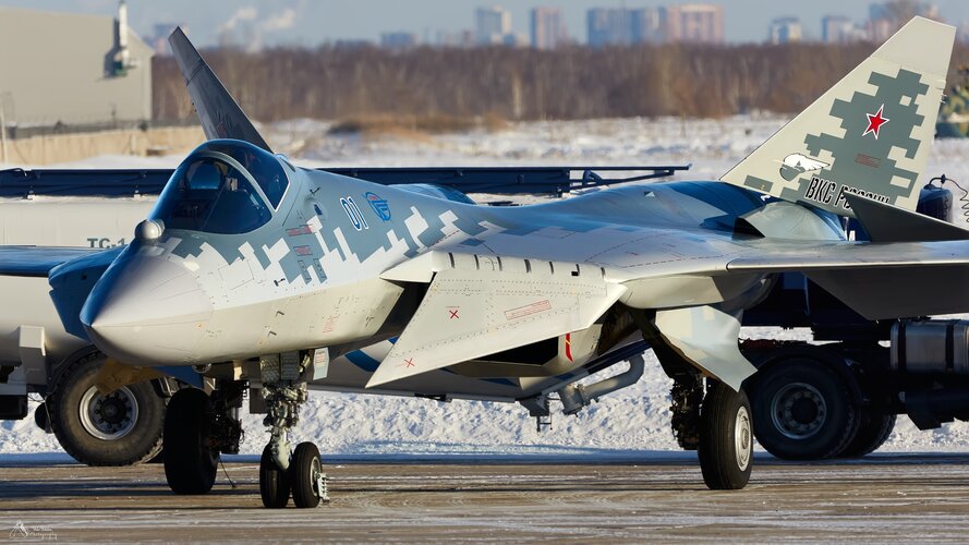

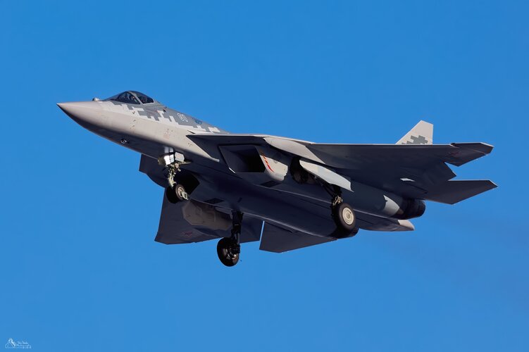

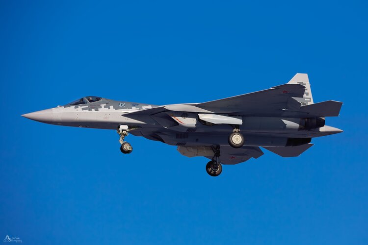

I don't get it; the top is pretty smooth with little paneling but the bottom looks rougher, my only theory is that they don't mind it much or they will address it once the new engines are around. This is still an initial batch, I imagine they will make some updates later.

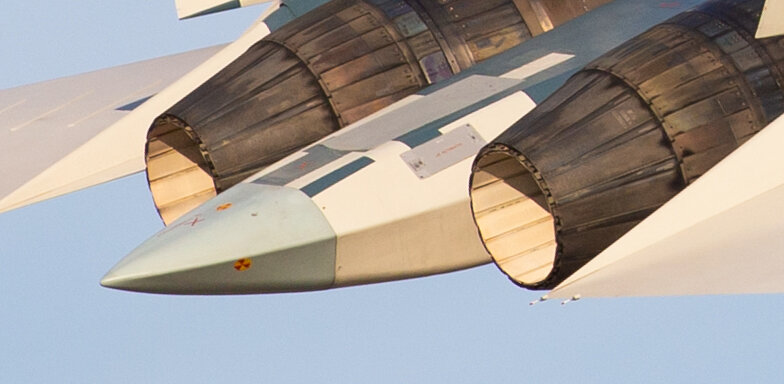

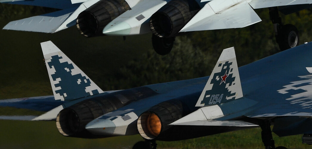

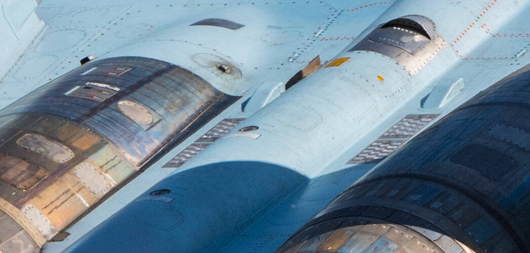

Those small new triangular exhausts on the engine nacelles top and bottom are interesting.

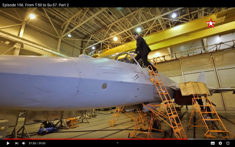

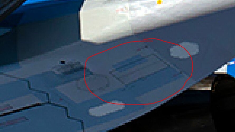

Also, was it ever confirmed what the three white panels are, right over the nose (In front of the IRST)?
The top looked super smooth on the factory photos, not a lot of pannels showing at all. This airplane certainly looks better, but some access panels Sukhoi just made them square or round and others have tooth edges, so I'm confused why. I still think that the aerodynamic layout of this jet seems pretty awesome, lots of wing area, adjustable lerx on the front, full moving tails, very thin design especially on the sides, there is not a lot of airplane visually and provably for the radar to pick up.
All that wing area allows the Su-57 to take off and land at small distances. In the last display from this video, the airplane looked like it had an excellent climb rate; the pilot appeared to pull more g's this time. Seems like it would be pretty good up high, flying fast giving its missiles extra boost by flying fast, then if needed could outmaneuver any other jet just by having more wing area and speed. Regarding the su-57 controlling drones, I think they might end up making a two-seater as it happened with the k-50. The workload might turn out to be too much, not by the lack of computing power but by human factors. How effective is the camo? It seems to be more to look cool than to be less visible, how effective is the blue camo on the Flankers? Gray seems to be the hardest color to see visually. I'm not bashing the su-57 I'm actually a fan of the Russian jets when it comes to aerodynamics, but so far they have lacked the sophistication in avionics, at least until the introduction of the Su-30, Su,35 and Mig-35. Sometimes I feel that the Russians could go the extra mile to make their airplane over the top, but they choose practicality instead. A philosophy that is more in line with the teachings from WWII.
Panels that cannot be sealed on the ground are serrated, the others are not. We can argue why or how, but it is like that. It is hard to say this was "overlooked" when you see pictures like the one below, where internal serrated edges are perfectly apparent right in front of the nose radome joint oriented right to the front. For some reason those joints do not generate the level of return some expect, probably because there is no electrical discontinuity, maybe edges are treated too, I don't know. It simply does not make sense to have that level of attention at some point as Sukhoi shows, "forgetting" the rest of the panels in the plane and then cheating to yourself at the RCS measurements...

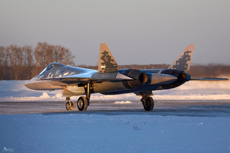

This is nice. I think i can see the radome edge treatment, angled. showing the main nose array are in tilted position.
Why?
Because it's the same placeholder seen earlier, with that conspicuous knob on top of the spherical portion. You're not going to swivel that around, and yeah, that's it.

It so doesn't. And now they're gonna fly it at GITs, where the earlier prototypes have flown (albeit "unofficially"), and reportedly the focus according to Russian news reports is to do even more weapons testing now. so hopefully we'll soon finally see some better footage of how all of that functions, but that I never had any doubts about anyway. I'm just saying, the "serial" bit about this airframe is serial in name only, as is its "VKS introduction". What is apparent is that the basic airframe is done and ready for mass production, with its impressively large and smooth panels etc, yet they have additional things to be applied to this "serial" machine.
PS correct me if I'm wrong but even disregarding the first and way simpler X-35, the first 2006-ish "production" F-35(A) didn't have the obvious serrated "tape" all over each and every fuselage panel edge that we see on production F-35s today, right?
You mean this knob?

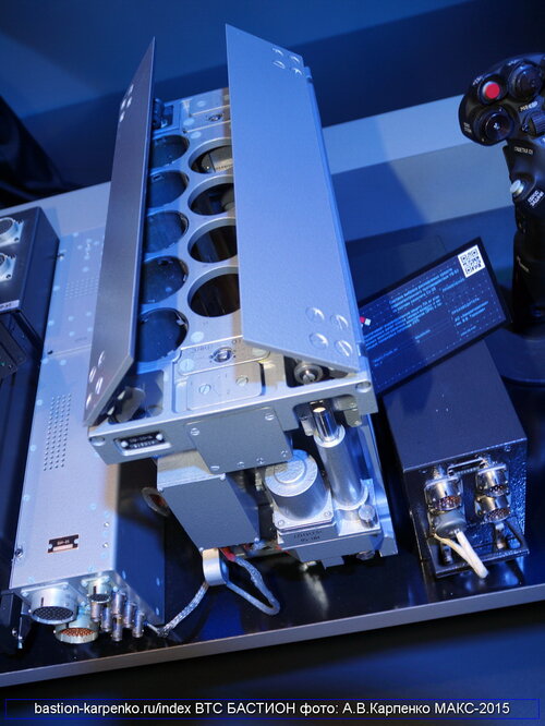

101KS-P - check.
101KS-U - check.
101KS-O - check.
101KS-V - check (even if doubted).
101KS-N - not present, which is expectable for ground pounding pod.
Am I missing something?
ESA antennas of S-111-N system - analogue of MADL.
Is that confirmed? It totally makes sense, but so would RNAV aerials (e.g. TACANski and/or ILS).
The production solution is slightly different (non-serrated):
As for the surface finish, it was fine all along really. I get the impression most of the people criticizing it simply had a knee-jerk reaction to something Russian-made or were comparing apples to oranges (fully coated production Western 5th gens against untreated early Su-57s). There was significant overlap with the crowd who went crazy about the presence of rivets (completely oblivious to the fact that F-22 & F-35 construction is the same) or felt the original titanium engine nacelle skin was a huge problem (ignoring conveniently that the *vast* majority of the F-117's surface area was metallic). In other words, they were clueless on the subject.

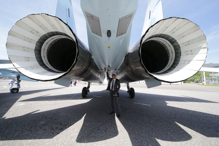

There probably will be some improvements slipstreamed into the production line as we grow closer to the Su-57M with Izd 30 and electric actuators. I've read there will also be ROFAR but I don't know how true that is.

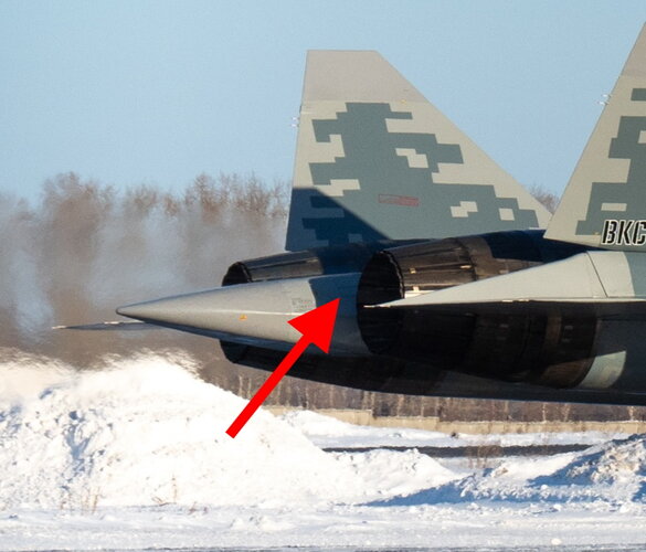

Also regarding the 4 triangle shapes on each nacelle, do we have any info if they are exhausts or perhaps some aerodynamic flow device? Maybe an aerosol dispenser for IR masking?

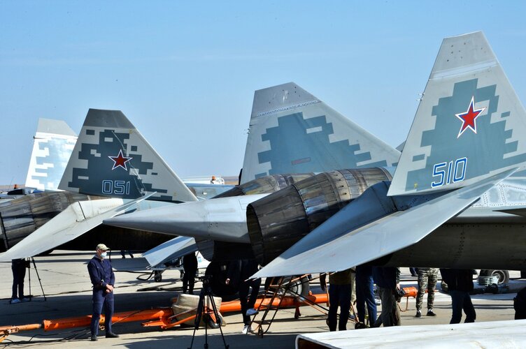

Seems my account over at paralay's forum has lapsed (not a big surprise, my last post appears to have been in 2012...), but there's a discussion going on about what the highlighted panel in the fist attachment is. Well, I think I happen to know the answer - it should be the UV-50 countermeasures dispenser, the top pair is also visible on one of the other photos.
1-4:052-509: old style,just like Su-35
5-7:510-511:new style
8-9:Su-35
OLS sphere rotates around its axis. Guess why.

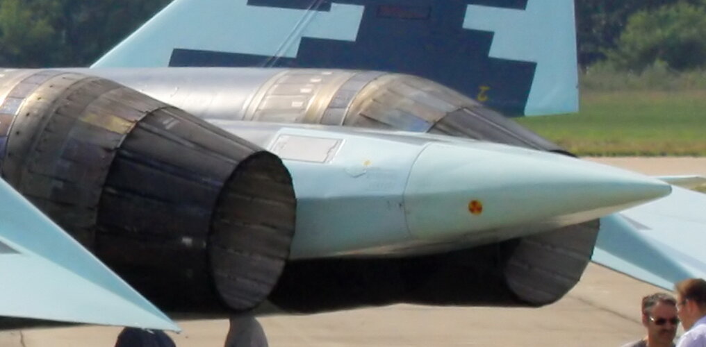

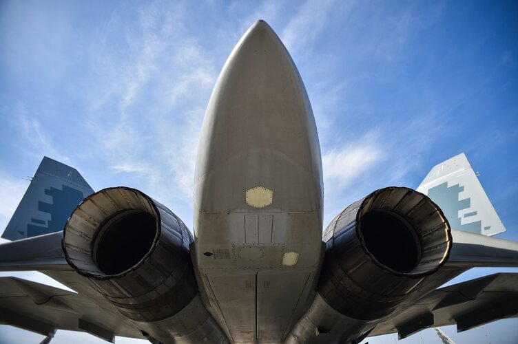

i dont follow the Su-57 well

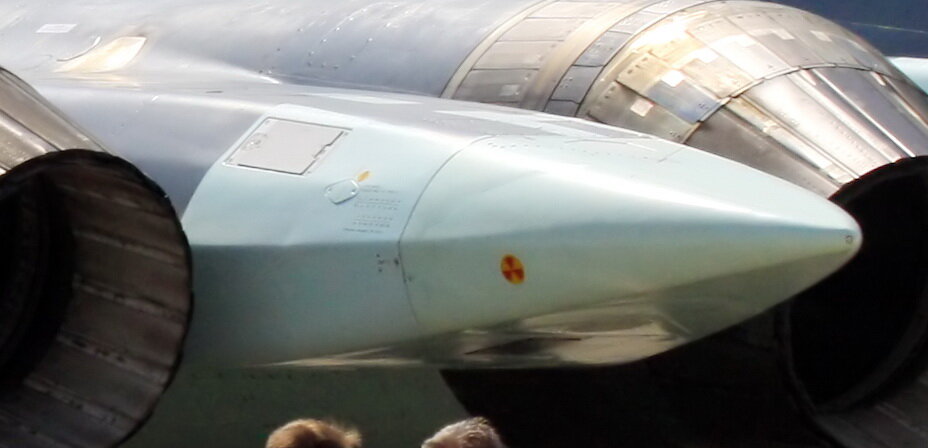

but is it just me or does this version's APU? inlet at the tail look different now. its angled forward
It has been discussed previously in the thread. Basically T-50-8 was modified with an inlet like that and both S1 (RIP) and S2 has it like so, so it is the production standard.
