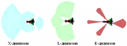

There were definitely L-band AESAs presented on MAKS 2007 (or at least the board next to mock-up says that) and the idea is to put them into the leading edges of the wings. This looks plausible, but we still don't know whether this have been a purposefull misinformation or a reality.
This isn't strictly "radar", its antennas for all the different radio emissions in different bands like radio, IFF etc.
