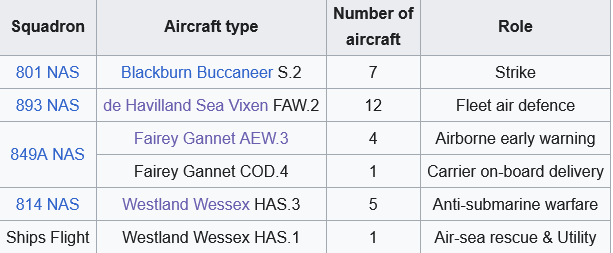

What kind of planes she would be able to operate? Her OTL air wing by 1970 consisted of:

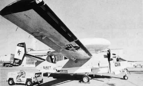

* E-1 Tracer AEW planes, perhaps? They are based on S-2 Tracker (which could operate even from smaller Melbourne), and their takeoff weight is roughly the same. While this plane is obsolete by 1960s, it's still better than nothing, and likely could be brought from USN supplies relatively easily due to being outdated.

The E-1B Tracer was retired from USN service late 1977.
Which gave ample time for Australians to obtain a pair of them. The introduction of E-2 Hawkeye started in 1964; by 1968-1970s, there were at least one wing (VAW-121) that operated E-1 Tracers, so the planes and spare parts could be obtained.
And by 1964 the E-2A was on the brink of disaster, cost overruns and teething troubles. The E-2B was being designed to try and correct the problems. All this probably extended the E-1B service life. Seems the Hawkeye really matured with the E-2C.

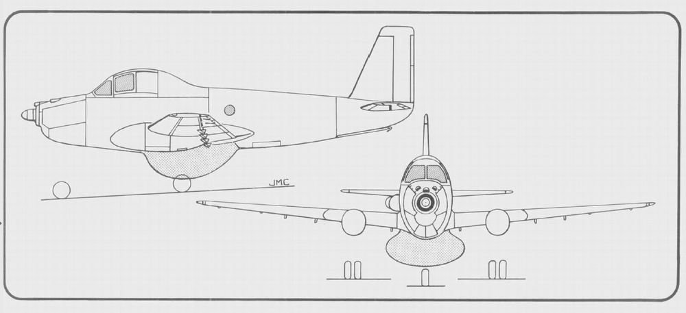

The Douglas D-701 buddy-buddy refueling nacelle is your friend (ha ha ha). Did wonder on the Etendard IVP, right off the 1960's. Yeah, I can really see your A4G refueling the Crusaders, makes ton of sense.

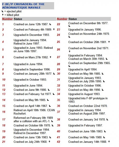

Please note that Crusader attrition may be atrocious, it already was in USN service on much larger carriers, and it was equally atrocious for the French, can't find the exact number. But the 18 modernized in 1990 (out of 42) were probably the atrition survivors, hence at least 24 crashed.
The E-2 is out of question for Hermes anyway; this plane empty is heavier than E-1 fully loaded.

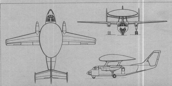

French Navy was actually interested in AEW planes, but apparently thought it would be cheaper to obtain them from French industry. French aircraft industry made several proposals (Breguet one was based on Alize, the Dassault was based on Spirale) but they went nowhere, since Navy could not obtain funds for development.
Breguet Alize-bazed:
Dassault Spirale III-based:
Yep, I specifically mentioned the desire to have a few dedicated tanker Skyhawks - so they could not only ensure Crusader's full patrol time, but also augment the strike capability.
True, but it's more or less unavoidable; Crusader is the only efficient interceptor that could fly from those small carriers. So... Australians better have a plan to continuously buy replacements for the planes they crashed)
