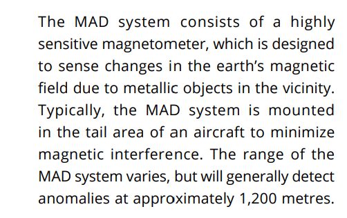

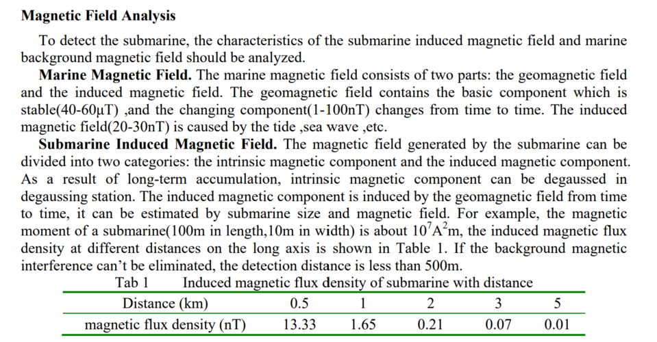

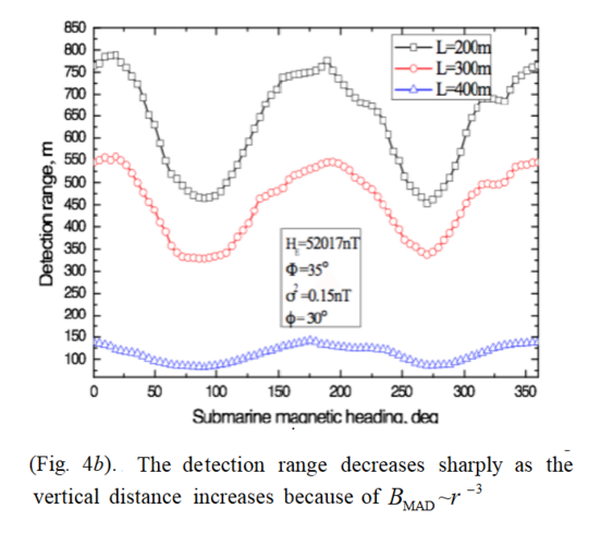

To be fair, now that I think about it, wouldn’t group of small drones with magnetic anomaly detector or LIDAR sensor find a submarine quicker than sonobouys?
