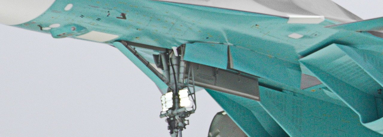

So the same thing obviously happened to the Su-34 after it's landing.
Please see images below, and discussion here. @QuadroFX
View attachment 758454View attachment 758455

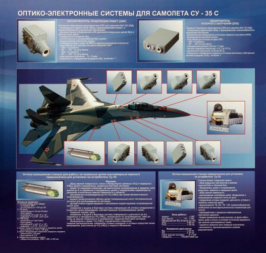

It seems that are new UV-based MAWS similar to that 'Zakhvat' UV MAWS on the Su-25SM3. It seems that UV based MAWS have some advantages over IR based MAWS?
@Saber
''OAR for Su-35 is IIR.''
Btw, SOAR ( OAR) as part of the self-defence electro-optical complex I-222 on the Su-35S are not IIR ( IR-camera,thermovision ) but simple IRST detectors working in the MWIR band ( on Russian 'teplopelengator') with working λ=3-5μm. SOAR detectors can detect incoming aircraft and AAM/SAM's. Smaller SAM ( MANPADS ) can detect from 10km, medium-range AAM/SAM from 30km and bigger/bigger range AAM/SAM from 50km with angle precision 1°.

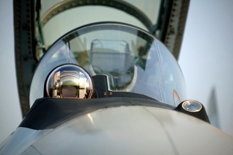

About OLS-35 ( diameter of the optical block is 200mm?), it has MWIR band IRST and there is so many promotive materials etc but there is no real data in them. Only valuable info that I've collected is one interview with the Nikolay Rakitin from the UOMZ in which he said that OLS-35 has four times greater detecting/tracking distances in comparison with the old OLS-27. If that is right what he once said ,we have some valuable data for comparison from the well-known Flight Manual for the Su-27SK with its OEPS-27E ( OLS-27E) .
''Дальность обнаружения истребителя на максимальном режиме работы двигателей на фоне чистого неба в ЗПС под ракурсом 0/4 – 2/4 составляет около 50 км, на фоне облачности,земли и водной поверхности 20 – 35 км, а на форсажном режиме работы двигателей в ППС под ракурсом 1/4 составляет 90 – 100 км. Дальность захвата цели составляет около 70 % от дальности обнаружения. Дальность захвата целей на максимальном режиме работы двигателей в ППС под ракурсом 5° - 15° составляет около 10 км. Для обеспечения большой дальности захвата высокоскоростных целей в ППС необходимо увеличить ракурс атаки более 15°.''
Transl...
''The detection range of a fighter at maximum engine operation mode( Military Power) against a clear sky in the rear hemisphere at an angle spect of 0/4 – 2/4 is about 50 km, against a background of clouds, land and water surface 20 – 35 km, and at afterburner engine operation mode in the front hemisphere at an angle aspect of 1/4 is 90 – 100 km. The target lock-on range is about 70% of the detection range. Target lock-on range at maximum operating mode in the front hemipshere at an angle of 5° - 15° is about 10 km.To ensure a long range of a lock-on of the high-speed targets in the front hemisphere, it is necessary to increase the angle aspect by more than 15°.''
During the first stage of the state military trials ( ГСИ-1) in Akhtubinsk air base in 2011 ,they achieved detection range of 80km against incoming fighter flying in non-AB mode.

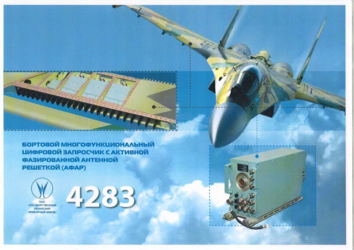

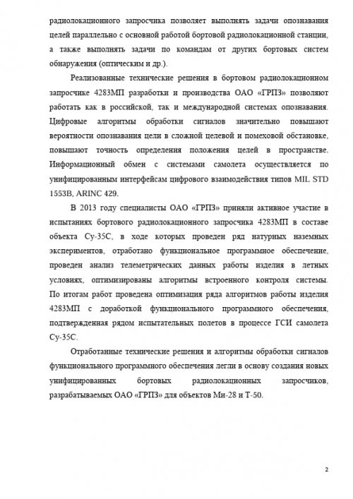

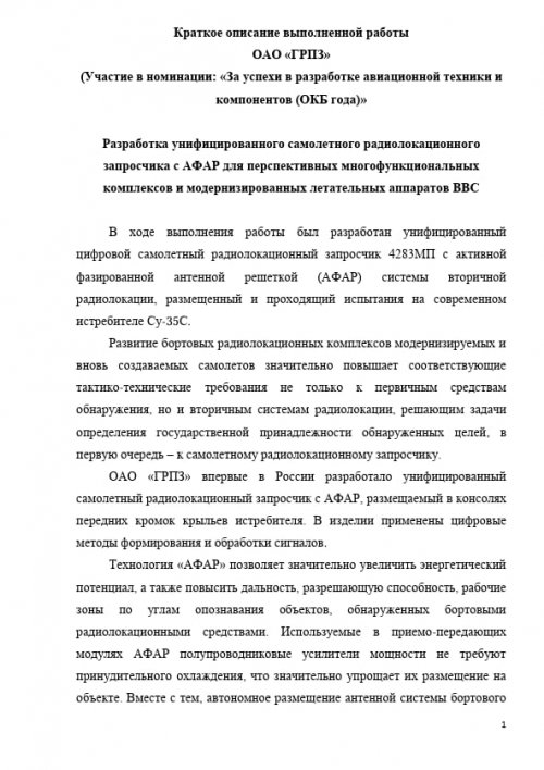

About that on-board multifunctional digital interrogator with decimetric L-band AESA type 4283MP for the IFF/ID inside of the wingslats of the Su-35S ,here is some technical details:
It was developed under the Project named Pokosnik or Reaper. It is possible to identify aircraft from the distance of 400km.Working frequency range is 1.03GHz -1.53GHz and it is divided in two frequency subranges.There is two working channels with two different working modes. First channel uses subrange which has working frequency range 1.03GHz-1.46GHz and it is used for the international identification with NATO standard MK-12 system.TRM in this mode has max output pulse power of 700W. Then there is second working channel for the domestic IFF under the Parol system with the frequency subrange 1.46GHz-1.53GHz and with max output pulse power of 500W. Average pulse power for the four-channeled TRM is 350W.Each IFF/ID antenna has three big TRM's with volume of 2.5l each.
One presentation : http://old.aviationunion.ru/Files/Nom_9_GRPZ_2014.pdf
Photo made in KnAAZ where we can see interrogator transmitt antennas of the L-band IFF AESA.

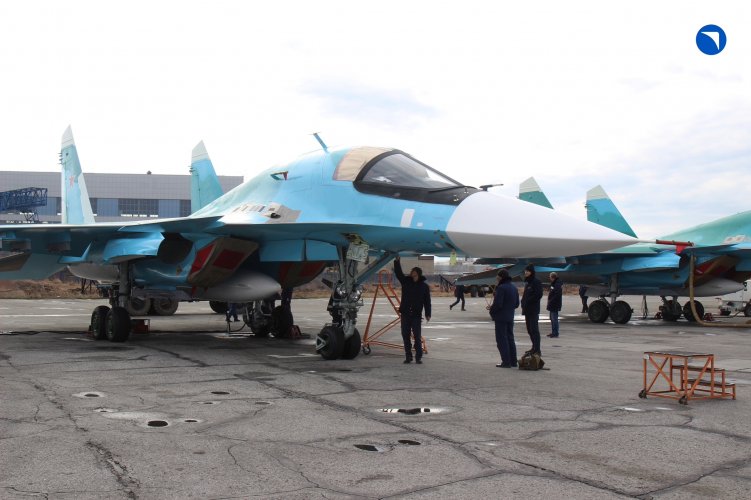

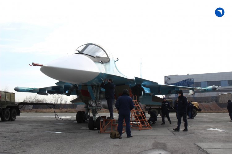

A way to get into Su-34

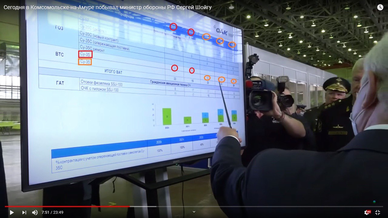

Hm, it seems that there is actual new state contract for the delivery of the Su-35S for the RuA&SF ?
First, there was the state contract for 48 Su-35S from 2009, then second from 2015 for 50 Su-35S and there was a third contract worth 70 billion rubles from 2020. It seems that production cost for one Su-35S in KnAAZ was about 2 billion rubles ( 20-25mil$) when we talk about first two contracts? Then after 2020 ,KnAAZ produced 30 new Su-35S for 70 billion rubles until the end of the last year. Some sources wrote that there were two contracts in fact ,one( the third) for the 6 and another (fourth) for 24 new fighters. In total, it is 130 produced and delivered Su-35S so far (128+2 new from today). Production cost after 2020 was higher, 2.5 billion rubles for one?
When we talk about loses,if I'm right, 7 were lost so far during Rus-Ukr war and one was lost on Sakhalin island on 2021.
