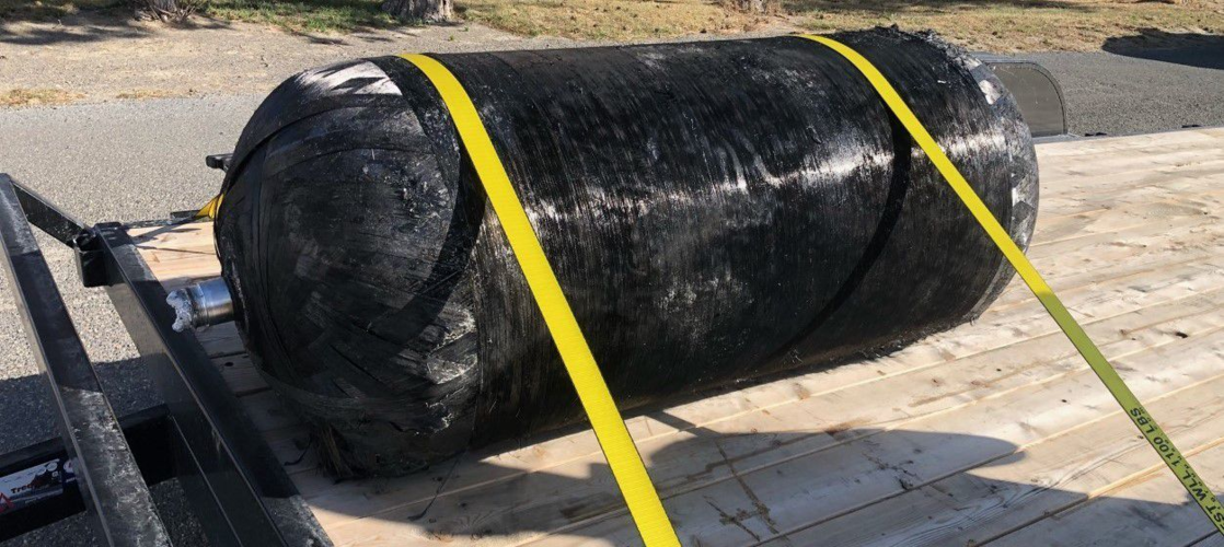

His stainless steel rocket design has criticism of its own because an atlas rocket crumpled from its own weight. The stainless steel he presented is 310S which corrodes at 2,000 degrees Fahrenheit and melts at 2,400 degrees Fahrenheit.
The Atlas rocket tanks were steel balloons, build from 0,25 mm stainless steel stripes (later 1 mm thickness in later version)
The tanks needed helium pressure at 1.43 bar during storage transport and installation on launch pad
Starship is build from 4 mm (now 3 mm) thick 304L steel and is self-supporting, it not need Helium pressure !
