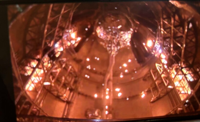

i check the video stream.
into flight of Starship 33
7m 40sec one of Raptors shutdown
8m 03sec the Raptor next to it shutdown
8m 04sec a Vacuum Raptor at those two Raptors shuts down
8m 16sec the Vacuum Raptor next to shutdown too
8m 24sec the last Raptor shuts down leaving one Vacuum Raptor working
8m 28sec Communication of 33 enden here.
9m 00sec planned engine cut off
Looks like one of Raptors detonate and starte chain reaction in engine bay follow by FTS

I wonder if this SS looked similar. If a Raptor exploded--that might also leave the hull looking as if hit by grapeshot.
If so--this could be a threat even to Lunar Starship even with it needing no TPS.

Musk suggests RUD was a consequence of insufficient vent capacity and is ready to march-on for a next flight in one month:
To be fair,I am not even allowed to shoot off fireworks in my state. I’m confident if I rained metal at orbital velocity on a random patch of the earth, there would be some guys at my door not some forms to fill out.
Musk has tweeted preliminary theory is an oxygen leak beyond the engine compartments fire bulkhead caused an internal overpressure too large for the vents to handle.
I.e. it quite literally blew up
Yes … according to him:
„Preliminary indication is that we had an oxygen/fuel leak in the cavity above the ship engine firewall that was large enough to build pressure in excess of the vent capacity. Apart from obviously double-checking for leaks, we will add fire suppression to that volume and probably increase vent area. Nothing so far suggests pushing next launch past next month.“
How about deal with the cause by eliminating or reducing the leaks vs dealing with the effects.
So any ideas as to why Starship broke up? Or will we just wait until we hear from SpaceX?
View: https://x.com/elonmusk/status/1880060983734858130
"Preliminary indication is that we had an oxygen/fuel leak in the cavity above the ship engine firewall that was large enough to build pressure in excess of the vent capacity.
Apart from obviously double-checking for leaks, we will add fire suppression to that volume and probably increase vent area. Nothing so far suggests pushing next launch past next month."
