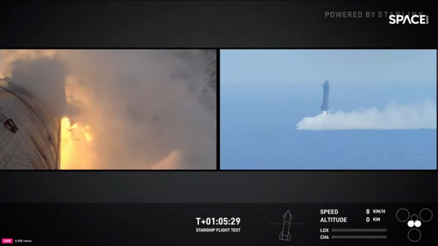

Related question: what exactly is the abort mechanism in a failed catch? They were apparently a second away from scrubbing the catch last time, but where exactly is the booster supposed to divert to in that scenario?
Flight 6 show the Abort option: crash in ocean near launch site.
others could be use Flight Termination System but falling debris drive environmentalist nuts...
another option is crash the booster on beach near launch side, but, you know the environmentalist...
