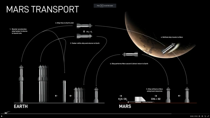

25:58: on Mars use starship as raw materials, not return them to earth usually
26:40: want to build multiple ships per day eventually for Mars. Next year demonstrate ship to ship prop transfer.
27:25: 5-6 refuel flights for every 1 flight to Mars

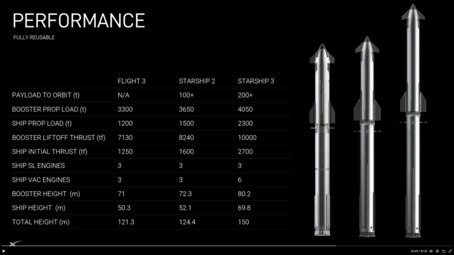

28:41: thrust for Raptor, 2 and 3. Raptor 3 is 280 tf sea level, 306 tf vaccum.
32:31: flight 3 40-50 tonnes payload to orbit, Starship 2 over 100 tonnes, Starship 3 over 200 tonnes. Starship 3 4050 tonnes booster prop load, 2300 tonnes ship prop load, 3 sea level raptors, 6 vacuum raptors (vs 3 vacuum engines previously).

35:18: thousands of ships to Mars every 26 months
36:10: 200+ tonnes to Mars per ship

"40-50 tons of [reusable] payload" for the current design certainly highlights how difficult and subject to mass-creep Fully reusable LVs are, even TSTO, even using the best hydrocarbon engines ever made.
In hindsight the SSTO of the 90s never would have had a chance to have any useful payloads, and the fully reusable TSTO NASA wanted as the shuttle would probably have failed to even approach its target payload on its first version.

One element in Musk speech is a bit puzzling. That present flights (theoretical) payload to orbit is a mere 40 to 50 mt to orbit. When their targets are 100 mt even for V.1.
Maybe they just build those test Starships as strong as crowbars - steel crowbars. Screw the propellant and payload mass fractions, after all they are test prototypes. What matters is to hit orbit, even with zero payload.
The point I'm trying to make: must take one hell of mass-fraction drop to half the payload. I mean, not even sure 0.75 in place of 0.90 can do it. Do these Starship have mass fractions as low as 0.60 or 0.70 ?
I think a good part of the performance drop comes from higher S2 gravity losses: Just look at the angle Starship was after separation!
With its 3 vac 3 sl engines, ideal would be to only run the vac raptors, Musk said some time ago they only want to use the 3 SL engines at the start of the S2 burn, but evidently they run them all the way through, he also said they really want to add additional engines.
Mass ratio is necessarily above 0.8 to even get to orbit and back with any payload
Personally, napkin math based on flight telemetry gave me Dry mass in the 130-160 tons range (0.88-0.9 ratio), not far from the one figure Musk gave years ago (120 tons) and the one DLR paper that estimated SS's mass (130 tons), but performances are extremely sensitive to the slightest change in TWR, dry mass, isp and staging speed. I really believe SX/NASA when they say they don't have enough data to tell how many tanker launches will be needed for Artemis.
Good points. 1200 mt divided per 40 mt would be 30 tanker flights (!). And 50 mt: 24 flights. A 100 mt payload would take 12 tankers...
The mass of Starship is 1330 tons (1200t prop + 130t empty) Vs thrust of 1250 tons.
The 3 sea level Raptors are inefficiency in vacuum.
Raptor 3 provide higher trust what compensated the gravity losses.
