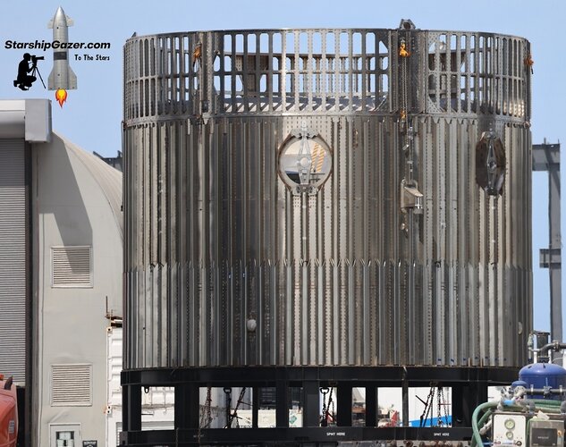

Here is a photo of the vented interstage test article:

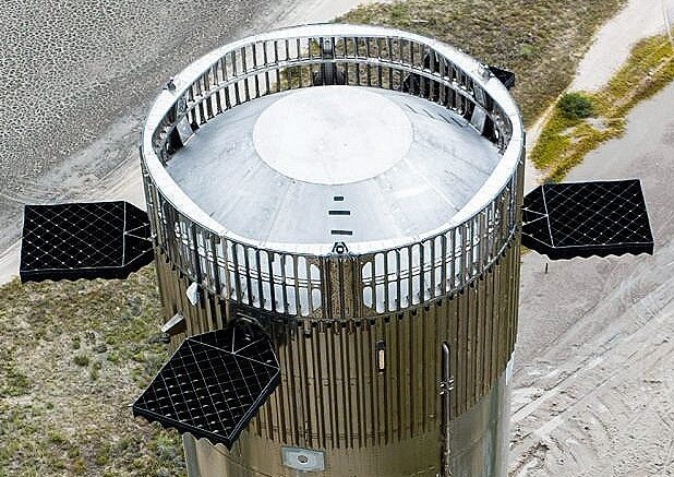

And here is the earlier posted photo of the final design as it is now on top of Booster 9:

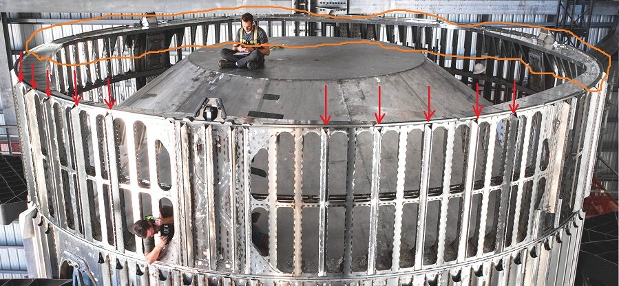

Note the differences with the test article:
1. About a third of the number of stringers (red arrows) now have an additional vertical profile welded on to their front to improve buckling resistance. The test article did not have them.
2. Triangular supports are now added below the upper ring and welded to the back of the stringers (orange envelope). If those triangles are intended to carry a considerable load then they should best have been extended down to the ring in the middle to avoid excessive stress on the stringers at the bottom of the triangle. The test article did not have these triangular supports.
Apparently the original design calculations that were the basis for the test article were too optimistic and the engineers got cold feet as a result of the tests. The 120 or so metal pieces they added may improve longitudinal strength somewhat but add nothing to improve lateral stability.

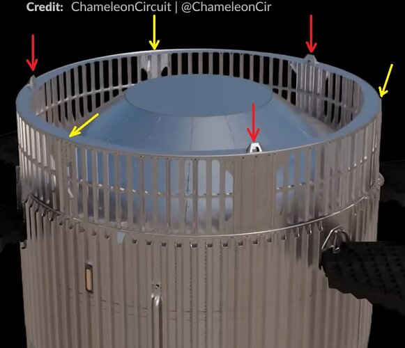

This rendering (not a photo) is from a similar point of view:
Note again the insignificance of the few rigid sections, and the difference in width of the three with a clamp on top (Red arrows) and the other three without a clamp (Yellow arrows). Making the three Yellows much narrower than the three Reds to save a few kilograms of weight could be the worst penny wise pound foolish decision in the history of SpaceX.
