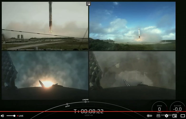

today is another launch of a Falcon Heavy
it took three years to have Client who need this rocket
and sadly it will be last time that Falcon Heavy fly as "The world’s most powerful rocket"
next time a Falcon Heavy is on Launch pad, SLS And Starship will have made there launches

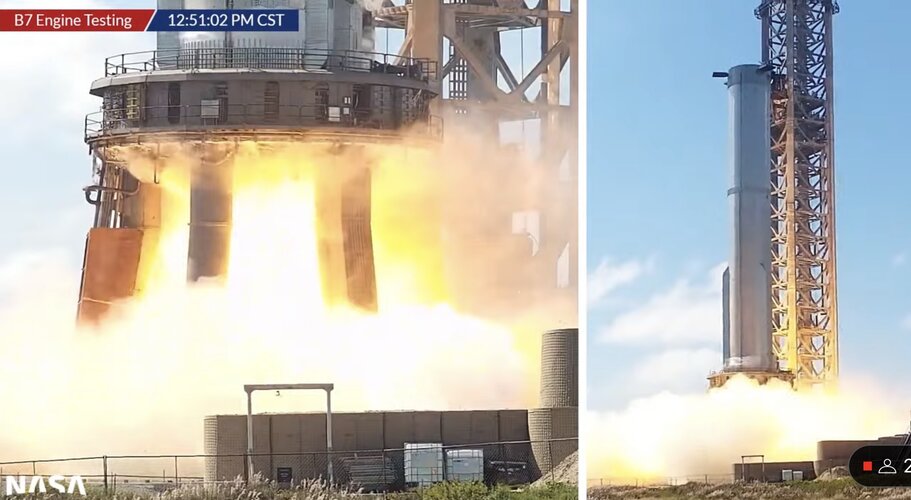

Pending official confirmation, SpaceX likely just conducted the most powerful rocket engine firing in company history.
View: https://twitter.com/nextspaceflight/status/1592230603197681664
Each Raptor has approximately the thrust of three Merlin engines. Falcon Heavy has 27 engines. Even if they ran at slightly lower thrust, I think it is safe to say the above is now confirmed.
twitter.com/elonmusk/statu…
View: https://twitter.com/nasaspaceflight/status/1592437205708214273
Super! How many repeat/incremental increase (number of engines) static fire tests do you predict until the full set 33 if all goes to plan?
View: https://twitter.com/elonmusk/status/1592441977525923841
Next test is ~20 sec firing with max oxygen fill to test autogenous pressurization, possibly one more static fire, then orbital launch attempt
