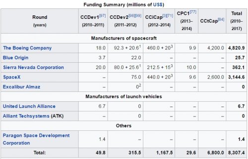

Commercial Crew Transportation Capability (CCtCap) Contract
CCtCap is the second phase of a two-phase certification plan for commercially built and operated integrated crew transportation systems. Two FAR-based, firm fixed-price contracts were awarded in September 2014 following an open competition. Through its certification efforts, NASA will ensure the selected commercial transportation systems meet the agency’s safety and performance requirements for transporting NASA crew to the International Space Station. NASA awarded a total of $6.8 billion under CCtCap contracts. CCtCap Source Selection Statement.
Boeing - $4.2 billion
SpaceX - $2.6 billion

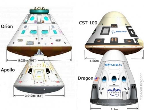

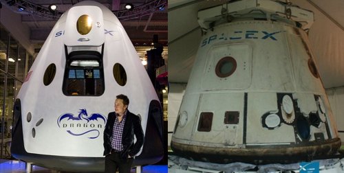

Not to drag this out too much but I just wanted to fill in the blanks. Boeing received early commercial crew funding that should have helped. Spacex did a drastic re-design which basically put them back at square 1. I would say company culture and how it affects operational tempo is more at play than start dates.
