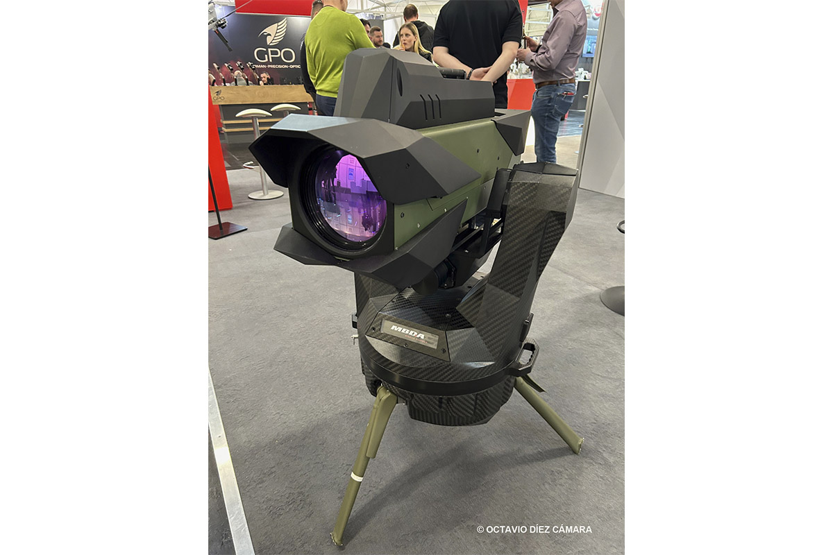

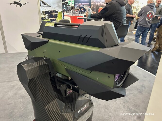

This is MILOS-D (Modular Integrated Laser Optic System-Dismounted) developed by the company MBDA Deutschland. It is an evolution of MILOS that began to take shape as far back as 2008, initial studies that, taking advantage of different critical technologies, allowed us to address application demonstrators in the terrestrial environment.
The tests, which took place at the WTD (Wehrtechnische Dienststelle für Waffen) facilities of the German Army in Meppen, took place in 2022 and made it possible to demonstrate its real capabilities and the versatility it can offer to whoever uses it; In principle, it would be intended for the German Infantry, for which new validations have already been scheduled to take place at the end of this year, also in Meppen
