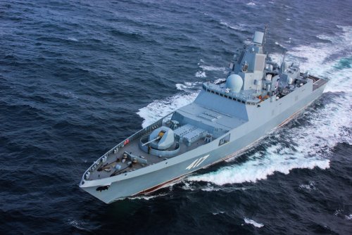

https://en.wikipedia.org/wiki/Admiral_Gorshkov-class_frigate

sferrin said:
bring_it_on said:
sferrin said:
Hmmm. No Tomahawk, LRASM, Harpoon or even NSM. Lame.
The OTH Weapon (NSM) has already been selected for the LCS and the FFG(X) with an objective of 8 missiles per hull.
But one wonders why they didn't mention the possibility of TLAMs or LRASMs in the VLS. Are they Self-Defense Length cells rather than Strike Length? ??? Hell, the new Russian Frigate has cells for 8 Kalibr or Oniks (Brahmos) cruise / antiship missiles. (Not sure why the two pictures are so different. They're both supposedly members of the same class. ??? )
Thpse pictures are not the same class. One is a Grigorovich class ship, not a Gorshkov.
https://en.wikipedia.org/wiki/Admiral_Grigorovich-class_frigate
TomS said:
sferrin said:
bring_it_on said:
Okay, fixed.
Just wanted to revisit this and talk about your main point re armament.
So, the Gorshkov has 16 AShMs, and 32 cells for SAMs. This is actually the same as the objective armament for the FFG(X). The only real difference is that the Russian ship's AShM are heavy, long-range weapons intead of "merely" 100+ mile light antiship weapons. Why? Because the Russian and US navies still have different views on the role of small combatants as offensive assets. The USN sees carrier aircraft still as their primary offensive arm (hence the emphasis on puttling LRASM on Super Hornet rather than surface ships), while the Russians see their destroyers as having a greater offensive role. Which is necessary because otherwise they have one barely operational carrier and a small (but potentially potent) submarine force.
Also, FFG(X) will have a few more capabilities in the surveillance and defensive role that the Gorshkovs lack. They carry both a helicopter and a sizable drone MQ-8C), both towed array and variable depth sonars (Gorshkovs has only the towed part), and a fairly robust torpedo defense capability. And some really robust EW as well, both SEWIP and AOEW on the helicopter (or maybe even the drone).
PS: almost forgot that SM-2MR Block IIIC brings the same high-speed antiship capability as SM-6, just with less range. That's a fair counterpart to the speed of the Russian AShMs.
