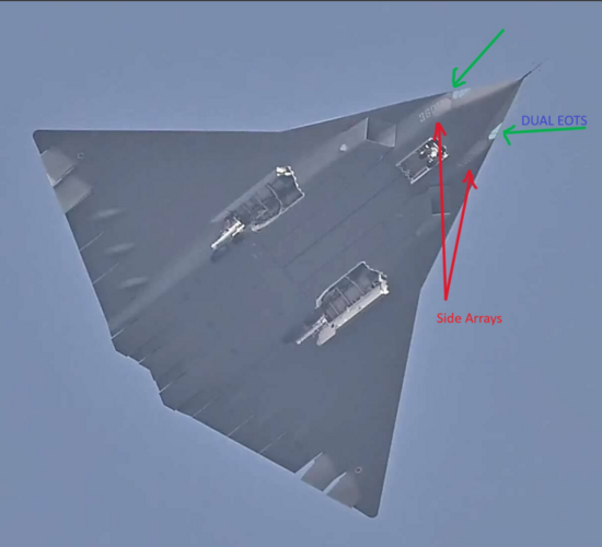

An interesting thought Ainen about side radars. Another thing is EOTS and IRIST sensors to complement the radars, I cannot see either on the prototype so far but I can see both on the fighter once it enters service.
Cannot see them? To me it seems that instead of having a singular optical window on the chin of the nose, this plane has opted for two optical windows on either side which are inline with the chine/edge. Gfx8zhFbcAAjgiS.jpg

Thanks Nx4eu, it is rather strange to see them on the sides and having twin EOTS instead of the single EOTS sensor like on the J-20 but I suppose that there must have been a reason for the change since having the J-20 flying operationally.

It looks like they are attempting a wide continuous field of view for an IRST. EOTS/DAS hybrid is my amateur guess. Wider field of view with more sensitivity/range.

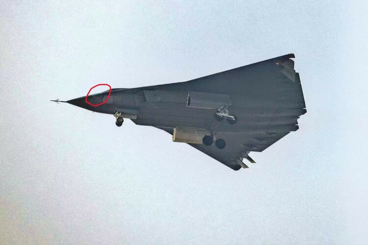

Looks like the flaps on J-36 doesn’t have traditional exposed hinges.
Notice the flight control actuator blisters are not in-line with the flow field but seem to be somewhat planformed aligned to the leading edges. The two outboard, split surfaces could possibly be using either an YF/F-23 multiple linear servoactuator arrangement or servo-rotary hingeline units which do not require blisters.
There should be some degree of overlapping directly ahead. Combining two inputs should allow for a virtual improvement in resolution.
The inner actuators are simply aligned the hinge line of the surfaces and then have a small bump covering them. You could put a larger bump aligned with the flow field but the actuator will still be the same orientation. For higher sweep hinge lines the flow field aligned bumps get large, so may not be a net saving.
Still working out the outer split panels. Maybe the different hinge alignment is to leave space onboard for a rotary actuator and torque tube in the slightly thicker wing section. Or might be an aerodynamics thing. But there's not a great deal of space for structure out there.
