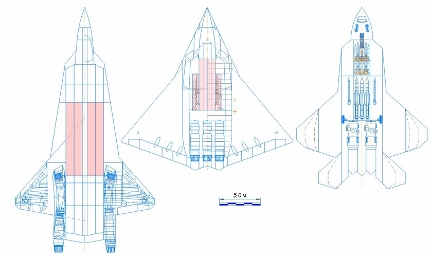

A channel with a volume of almost 8 m3 passes through the 94 m3 aircraft, 8.5% of the useful volume is purely for purging and placing another engine. Isn't it too greasy? And it could be a tank with 6.4 tons of fuel...
PAK DP, J-36 and NGAD

Having a third engine for a supersonic aircraft is much more critical than for a subsonic one. We are losing internal volumes to the engine itself and the air intake duct. And there could be fuel there ;)
Well, one needs similar levels of airflow for two large engines as one needs for three small engines - correct? One might have more duct losses due to higher surface area, but it might also be structurally easier to use three smaller ducts rather than two larger ones?

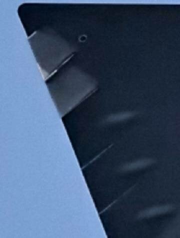

Will be quite interesting if side radars and optics are in fact main ones.
I would think anything forward mounted would be redundant at those angles? The B-21 appears to use a pair of side facing radars admittedly with significantly lower sweep, but AESA arrays should still give good forward coverage with some overlap.

Another factor is engine type availability. If the aircraft has 3 x WS-10 or WS-15 engines then that's 90-120,000lbf total. And China simply doesn't have 2 x 45,000-60,000lbf fighter engines lying around given their 10+ year development timeline. So if you need that much thrust now, then you simply stick 3 existing engines.

Is it worth it, when you can use 3 from available pipeline, and still get the capability and unified supply?
Soviet Union used to feed engine design houses by making new engines for everything, didn't end well.
Also, China doesn't have that many of them, to make a separate oversized supercruising engine.
