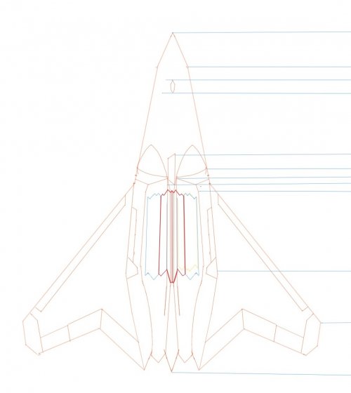

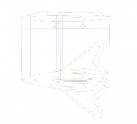

Based on the most recent images, I wanted to make my own sketch of the Shenyang aircraft, and it's possible weapons bay configuration. In my opinion, at best it would have a weapons bay only marginally longer than the J-20. Which I have marked in yellow. The perspective was weird to work with but I think I've got something decently sketched up. IMG_0539.jpg
Edit: The cockpit area looks goofy but there's no information on how that would look other than the peak being in front of the nose wheel so that's the best i've got.
Based on the most recent images, I wanted to make my own sketch of the Shenyang aircraft, and it's possible weapons bay configuration. In my opinion, at best it would have a weapons bay only marginally longer than the J-20. Which I have marked in yellow. The perspective was weird to work with but I think I've got something decently sketched up. View attachment 766454

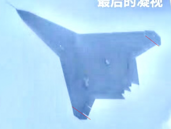

Tip: Its mobile wing tip section should be parallel to the plane itself.There are public papers that can support this point(Careful observation of the wing tip in the photo can also reveal).I hope it will be helpful for your drawing. : ) 1744431978188.png
Tip: Its mobile wing tip section should be parallel to the plane itself.There are public papers that can support this point(Careful observation of the wing tip in the photo can also reveal).I hope it will be helpful for your drawing. : )View attachment 766475
Thank you, even the photo I used as the reference has this parallel wing tip. I must've brushed over it when I was drawing the wing tips. I was far too focused on the weird intake/belly configuration. I will hopefully make my own 3d model as well when I get more time. I also do understand that the tail is also drawn a bit off, that will be fixed as well. 1744434395355.png

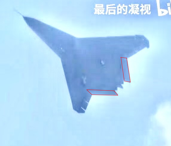

The wingtips and nozzles look a tad bit too small IMO (since the reference photo was taken from an angle) and I wonder if the IWB doors are a part of the groove so that one or two PL-17s can fit in the centerline.
But I think you're somewhat right that the separation line (? how else can I call it) between the wing and the wingtip goes inwards a bit before becoming parallel (I think the reference photo does show it), akin to how the J-20's intake outline cants inwards a bit to hide the gap between the canards and the fuselage.
I agree the nozzles are drawn a bit too small. I personally disagree with the notion of a centerline weapons bay in the groove. Placing a weapons bay in a groove not only is volume inefficient but it also complicates weapon release, and is potentially more dangerous. Secondly I don't believe that doctrinally the J-XDS carrying VLRAAM like PL-17 makes sense, that job is relinquished to it's bigger partner, the J-36. I believe the Shenyang aircraft has a groove due to a structural decision in the airframe and the how it relates to the weapons bay. The shape is of the two sections are very rectangular, design wise, it's almost completely obvious that it has two large weapons bay on each duct structure, especially when you compare the rectangular structure to 5th generation bays that are very rectangular like the F-22, J-20, and J-35. I personally suspect that these two bays while not significantly longer than the ones present on the J-20, are much deeper. Which relates back to my structural point in the beginning. I also believe that the groove serves some aerodynamic purposes, but that's my theory on the distinct design feature.
Edit: I know the Su-57 has a some kind of groove like weapons bay in-between the two engines, I don't believe it's a equal comparison with what's shown here. The gap on the airframe is very small compared to the Su-57, the nacelle design also in my opinion strongly points to weapons bays being in the red locations, this is very different than what is present on the Su-57.

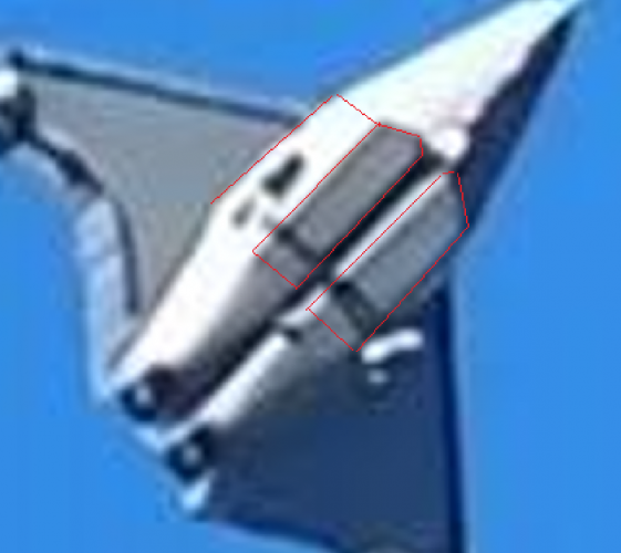

I don't think you're getting what I'm trying to get across. I'm not trying to say an individual centreline IWB exists, but rather it as a part of the main IWB. So not a conventional, completely rectangular IWB. The sides are still around the length of the J-20/35's IWB, only the centre part being slightly longer (and deeper relative to the other parts of the IWB to compensate for the groove), kinda like the Chinese character "中". So the IWB doors split at the centreline of the groove but as part of the groove structure when closed.
Like this (obviously, length, shape, serrations isn't accurate but you get the general idea. It could also just purely extend out from the back and uniform at the front but that might take up some engine bay space):
The red outlines are a whole piece (obviously splitting from the middle and hinging on either side's IWB part-door like the ones on the F-22/J-20/35 except just longer in the middle).
Carrying and lobbing multiple PL-17s obviously isn't its main job, but I think it makes sense doctrinally for it to carry just one or two of them to enhance its air superiority capabilities.

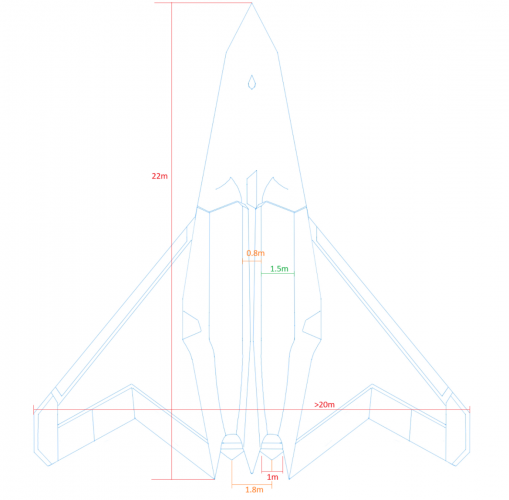

Both your drawing and Paralay's look a bit short and 'fat' to me?
I think it's just a general scaling what the perceived known sizes are like I think I drew the wheels too big. The fuselage probably looks a bit fat from the bottom view because the sides are angled so on a projected bottom view they make the entire fuselage a lot fatter, but in a 3D perspective it doesn't seem to add much width.

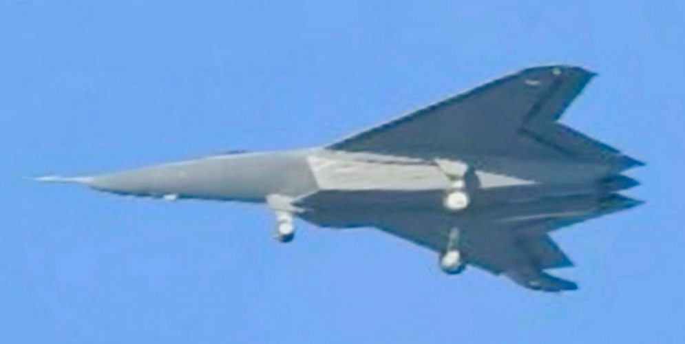

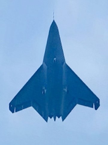

Belly shots from SDF.
Edit: One thing I can note is that this thing probably utilises supercirculation lift pretty darn effectively like the Raptor.
The flat rectangular vectoring exhausts seemingly sit only a few percent of chord behind the wing’s trailing edge. That tight chordwise offset is ideal for circulation control. Any high‑energy flow issuing from those nozzles (especially when deflecting) can more readily re‑energize the boundary layer over the flap/wing junction and “wrap” around the wing’s bound vortex. Pretty sure that's how it works on the Raptor, except it has the nozzles beyond the trailing edge and this has the nozzles behind.
