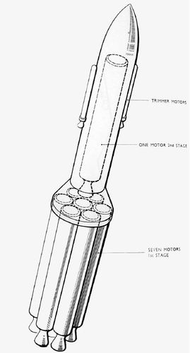

I think you being a little overoptimistic here. There was a proposal for a solid fuel alternative to Blue Streak. I attach a drawing.
Note that the first stage contains seven rocket motors, each 3'6" in diameter.
Well that seems rather like a parallel to the Solid Jupiter type missile and as such might explain 42 inch cylinder fuel press.

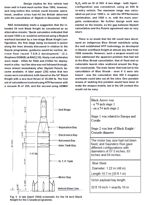

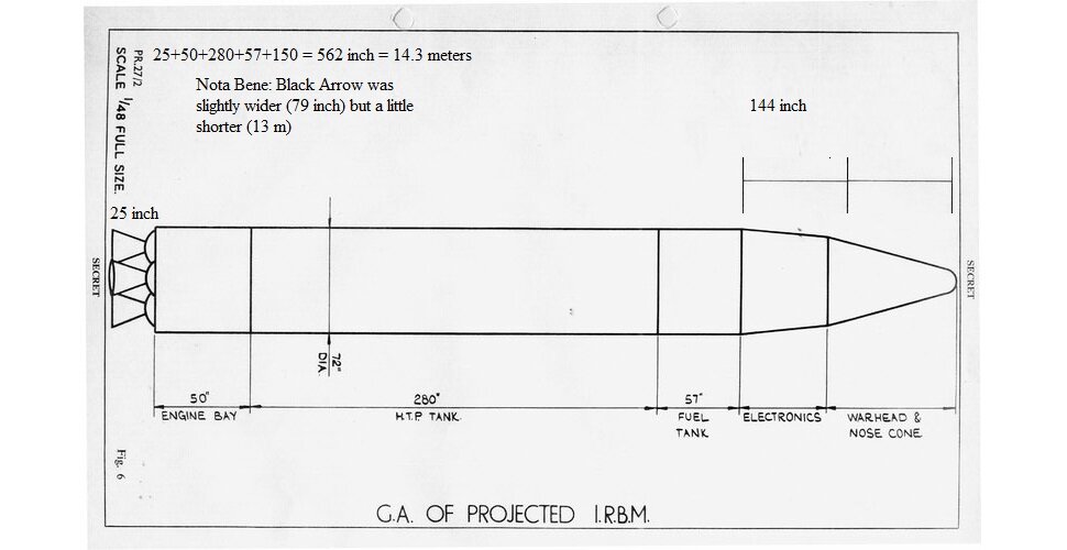

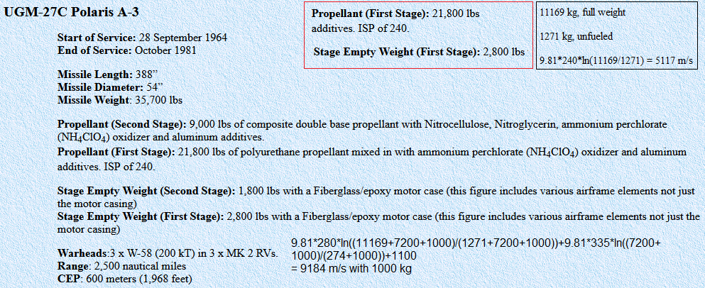

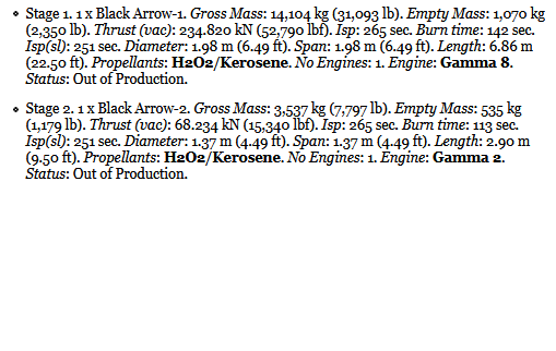

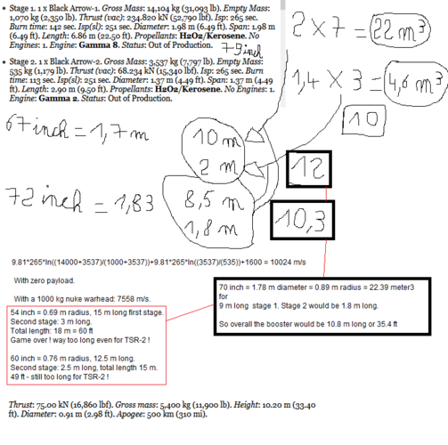

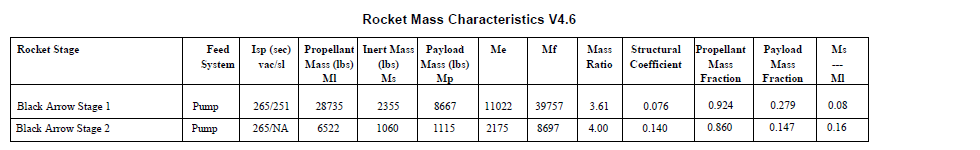

I did some calculations related to diameter (see the attached picture called "volumes")
- Black Knight was 36 inch, too small
- CRUSADE was 54 inch
- Black Arrow first stage was 79 inch, it's second stage recycled CRUSADE 54 inch proposals.
The orbital Black Arrow threw 200 pounds to orbital velocity which is Mach 27.
An ICBM if not a FOBS won't go into orbit but to Mach 20
IRBM / ALBM / SLBM are merely Mach 15
So quite logically, an ICBM Black Arrow to Mach 20 can throw much more weight.
For once the exponential nature of the rocket equation helps instead of being such an annoying PITA.
A Black Arrow ICBM should be able to throw at least 2000 pounds to Mach 20.
When imagining Black Archer I shrunk / enlarged both stages to 68 inch, because it is right between 54 inch and 79 inch.
Why ? Because such a missile would fit under a TSR-2 belly.
Fundamentally, kerosene / peroxide is extremely dense (1.4 for HTP compared to water) and it is possible to build ICBMs or orbital vehicle that are extremely small and compact.
Black Archer would be small and compact enough to fit inside
- the prototype K-11 silo at Spadeadam
- contnairs on ship (Atlantic Conveyor, is that thou ?)
- rail carriage (fits inside the old tunnels)
- road trucks (roaming the countryside)
- Polaris / Poseidon launch tubes in submarines
- TSR-2 belly
- Vulcan's Skybolt wing pylons
- Victor and Valiant bomb bays
- AW.681 and Belfast transports
- Modified Concorde or VC-10 airliners

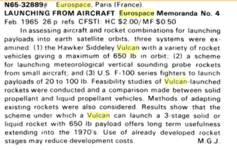

- Could go either ICBM or FOBS if needed
My conclusion: by carefully picking the correct diameter to length ratio, it would have been possible to create a 2-stage ICBM / LV / FOBS that fit a) a TSR-2 belly undercarriage ground clearance and b) the Victor bomb bay.
The Vulcan and all the others just don't care, but these two are the ones fixing tight size limits.
I wanted Black Archer to fit all the platforms listed above.
With a POD more or less similar to that brilliant story

A recently declassified file from 1975 on Polaris Chevaline detailing the decision to proceed with development.
If I may add a note not covered in the linked article;- In 75 the Royal Navy couldn’t accept the idea of liquid fuels anywhere within the weapon system (note we’re only talking about the 3rd stage manoeuvring bus). Prior to this the RAE had proposed a cold gas bus manoeuvring system using high pressure nitrogen gas precisely metered at the thruster . This was the system tested on the Falstaf rocket flight test as a technology demonstration, except it didn’t work. It had worked well in the vacuum chamber but not in low gravity….. just as few US experts had predicted. Hence the decision to adopt a liquid fuel, which needed the Admirals to be overruled, went right to the top;- no other than the PM himself.
Another note here is the variants quoted in the table;- I reckon “pyrotechnics” refers to the bursting charges in chaff bundles, “Solid fuel”refers to motors in the decoys and “liquid fuel” refers to the power source for the manoeuvring bus which produced the widely dispersed threat cloud.
Yet another note;- The RN condition for accepting the liquid fuel solution was only on the basis it was sub contracted to Raytheon as technology world leaders, reassuringly expensive and requiring very high level US blessing.

Yet another note;- The RN only accepted the liquid fuel solution only on the basis it was sub contracted to Raytheon as technology world leaders, reassuringly expensive and requiring very high level US blessing.
Which is highly ironic as what ultimately killed Poseidon for the RN was that the US wasn't willing to export the MIRV bus, meaning that the UK would have to develop its' own at considerable cost and technical risk, leading to forecasts of UK Poseidon entering service two to three years later than Chevaline. Of course, Chevaline encountered its own delays, no doubt due to the same technical risk, and entered service in the timeframe forecast for Poseidon - which would presumably have been even later.
The US actually suggested Trident C4 at one point for the RESOLUTION class, as the RN timescale for procuring Poseidon was long enough that the US would have stopped producing it!
