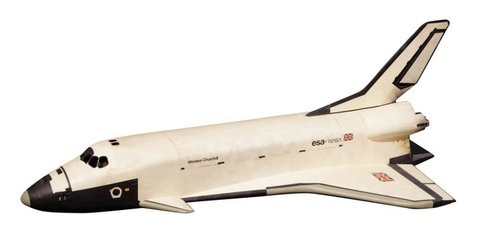

To uninvent Polaris would be as much of a fantasy as uninventing the jet engine. Yes, Britain could have built its own SLBM in the 60s just as it could have built its own Space Shuttle in the 1980s. But the circumstances that would have allowed this to happen are as fantastic as Sir Alf Ramsey becoming Prime Minister, which as a British Citizen he could do in an alt history fantasy.
