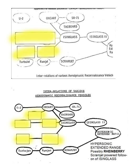

Unless I have missed it, these are two separate docs with the same diagram, and has anyone requested unredacted versions of these docs so we can see what the five redacted reconnaissance platforms are?
Sublight, I have made a FOIA request for INSINGLASS and RHEINBERRY, however not those programs that preceded them. Attached is a CIA document from approximately the same time listing some of the aircraft in the diagram. Unfortunately, it would be simply speculation as to what is under each redacted bubble.

You can request the redacted pages of already released documents and request the redactions be reviewed and minimized.
Thank you, I'll look into contacting them. Hopefully they won't wait a year or more to deliver the unredacted documents.

I filed one with CIA today for a document that was redacted and released in 2010. I asked that the redactions be reviewed because it had been 15 years and I believed they had made an error in making redactions that did not have a solid legal basis (a dead UAV program does not fit the legal definition of an intelligence source).
Maybe in a few years I’ll get a release. Or like other requests about this program they’ll send me a nice glomar response in a couple of days

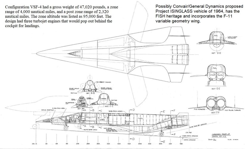

Matching up the information and the timelines for the Convair/General Dynamics Project ISINGLASS, contract NA-2000, a very likely candidate for the proposal was the VSF-4A. It was the focus of the Phase 3 design study by Convair/General Dynamics for the A-12 replacement according to Code One. It is a descendant of Convair's FISH project and uses the F-111's variable geometry wings design. (Note: Isinglass is a gelatin substance found in fish. Curious if the ISINGLASS codeword originated due to its connection to FISH.)
