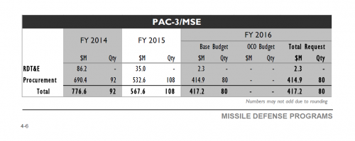

PAC-3s are about $5 million, SM-3s $17 million or so and the Block IIAs something like $30 million.

sferrin - a PAC-3 costs $5mil? That's a pretty nasty cost, as I thought those would be the budget option against sub-munitions. Against cruise missiles or stand-off PGMs, which may cost around $1 million, ridiculous. The problem gets worse, as every military branch now has to worry about cruise missile attacks against any base, from CONUS up to the front line. Are there enough Patriot batteries to cover the major possible targets?

MSE with full scale production just imposes a cost constraint on the US. If a cruise missile can be shot down by a $500k Stunner, buying Stunners for anti cruise missile role saves the US $4.5 million. That money can be pushed into buying offensive weapons, which are very much lacking in the Army. Heck, I've wondered if the Iron Dome interceptor can be used for anti-cruise missile missions. Shift all the cost and technology to the radar and engagement system then use the cheapest weapon possible to shoot them down.
I was just adding a similar thing into my reply as you were typing. The US has looked at these sort of weapons, and we have a study here that looks at even cheaper low-cost interceptors. With Hit-To-Kill, you can bring size and cost down as the Stunner has showed, particularly if it can be standardized (or components of it) with a larger missile program. The CUDA concept looks promising to me for such a role and the stunner essentially does that with a dual mode seeker. You can go even cheaper for even cheaper munitions.
The IBCS essentially allows you to do this, and if you go back a few pages you'll see that Raytheon has plans to offer different interceptors at different price points. Cheaper integration of nodes especially when the interface is Army/DOD owned should make this much faster, cheaper and increase flexibility.
Another thing to look at the cost curve once higher rate production takes over. Compare the LRIP PAC-3 MSE cost to the 100+ SM6 (?) cost in the FY16 budget -

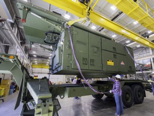

Looks like they're talking about just the radar. And here I was hoping for a mini-HEDI. :(
Modernization upgrades may keep Patriot in operation until something truly different in concept (or price) comes along.
https://www.youtube.com/watch?v=ix4kse6ZRBo
https://www.youtube.com/watch?v=dymCjQD0B3Y
https://www.youtube.com/watch?v=EHRvyaN9gjI
Geez that is sad.
They had MEADs and they just threw it away, and will now spend all this money to upgrade the archaic Patriot.

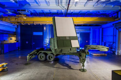

http://aviationweek.com/defense/gan-enabled-patriot-radar-upgrade-raytheon

There are three components for the Patriot system upgrade. The first was the introduction of the MSE. That happened recently with its induction. The second was getting the IBCS contracted and developed. IBCS is just a few years away from IOC, and Northrop Grumman has really opened the system and has created an architecture that the Army owns allowing them to compete various enhancement and interoperability initiatives such as getting JLENS integrated, getting the Sentinel integrated as has been demonstrated. The third phase was always to upgrade the sensor. The MEADS approach would have been the best perhaps with a fixed x-band radar to accompany a UHF radar. That approach would also be the most expensive. While the GaN Patriot does offer a relatively low-risk path to upgrade it is still an upgrade when many believe that they need to pursue a totally new sensor. The current AOA is looking at that, and a few pages back there is a defensenews article that that discusses the options. The GaN patriot would still have to compete going forward. Lockheed Martin will most offer an X-Band radar, also using GaN with Northrop Grumman offering a version of their GATOR. Raytheon has in the past looked at least 2 configurations for a 360 degree upgrade (artwork posted earlier) while they have also considered a clean sheet X-band design also utilizing GaN that they now are offering for AN/TPY-2 production. By the end of this CY we should know a lot more about what direction the Army takes but eventually it would depend upon the next POTUS and what resources are projected over the next 5-10 years.
You keep saying ancient. Do you honestly believe the system hasn't been upgraded over the years? Furthermore MEADS is inferior in some regards due to it's lack of a long range missile. It would take more batteries to provide the same amount of coverage.
Thats a minor problem since a long range interceptor for the MEADS is only a function of investment. The problem with MEADS is acquisition cost and getting it to be compatible with IBCS which the Army, rightly sees as its future architecture. The best option, provided availability of funds would be to pick up elements of the MEADS such as surveillance radar which lockheed has designed around commonality with the FCR. You can then look to integrated the PAC-2 with the FCR or develop a new interceptor which would be required for the 2030's anyways. Patriot replacement isn't projected to be in service till the second half of the 2020's anyways if not early 2030's.

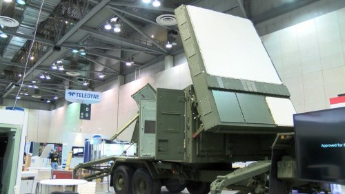

The RFI for a GaN based AESA Patriot radar replacement/upgrade went out on Friday. They are looking at L, S, C, or X frequency bands which I found interesting given the three different bands offered by the three competitors for 3DELRR (which is supposed to award this month). Might necessitate some MRFDL modifications; PAC-3 MSE supports at least X-band and C-band.
RFI: https://www.fbo.gov/index?s=opportunity&mode=form&id=3f1a8cff92f6fb867108ab02efb3a424&tab=core&_cview=0
LTPO-GSE requests information on AESA Antenna radar technology already developed or in development that could be utilized to upgrade or replace the PATRIOT radars fielded by the US Army and International Partners. LTPO-GSE will assess industry responses for AESA Antenna upgrades to the existing PATRIOT radar and/or responses to replace the existing PATRIOT radar with an AESA Antenna based radar. The maturity of the AESA Antenna technology must be at a Technology Readiness Level (TRL) of 6 or higher and manufacturing processes must be at a Manufacturing Readiness Level (MRL) of 6 or higher, or have the ability to reach a TRL/MRL of 6 or higher within eighteen (18) months after award of a technology maturation and risk reduction type contract. The objective of this RFI is to assess current, gallium nitride (GaN) based AESA Antenna capabilities within the US defense electronics industrial base, particularly as they relate to existing and future PATRIOT radar specifications and capabilities. The key objective for a potential PATRIOT radar replacement or upgrade to AESA Antenna technology is to reduce overall radar Operation & Support (O&S) cost out to FY40 while maintaining and/or improving radar performance against emerging threats. Goals of the PATRIOT 30 year strategy are to reduce the PATRIOT radar O&S cost and to extend the service life of PATRIOT legacy missiles to 40 years.
Responses to this RFI will be in the form of yes or no to the specific questions, listed below, with a brief justification or rationale not to exceed 200 words per question.
