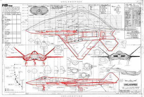

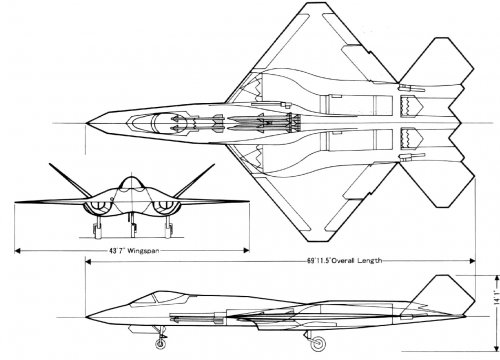

Interesting to note, how official F-23A drawings match 1990s Koku-Fan one, except some minor differences.
Also note - Koku-Fan has much more detail on weapon placement...hmm...
Yeah, I noticed that as well. But you have to remember, we only have one page of what may have been a multiple page set. I can't read it that clearly, but does it read "4" in the title block? If so, I'm willing to bet one of the other pages had the weapons bay/weapons system info. But you can kind of tell where the missle bays are on the drawing we have, based on the fuselage break you can see on the side view and the open areas in the section view. Although, it would have been nice to be able to see the weapons bays door configurations in this drawing. ;)

High res copy here: http://www.secretprojects.co.uk/YF-23%204%20View.gif (1.35mb)
Hi guys,
I am having problems opening this high - res pic. Is it something with the link having gone bad or is it my computer?
Thanks!
Your computer. Link is fine. Its pretty huge though - try right clicking the link, save, and then open from your computer into an image viewer.
Taking that one down to the print shop, get an A1 copy printed up and mount it on my wall! Great stuff.
Interesting to note that the engines are canted inboard about 2 degrees.

This guy at milviz says the drawing just posted by Mark is a fake by Matej at this site. Based on people I know and other information I've been able to acquire, this drawing seams to match what I know. Besides, I didn't know Matej knew how to calculate area distribution plots and as good as Matej's drawings are, I've not seen anything like this from him. ;)
Any thoughts?
I sincerely doubt that the F-23A drawing provided by Mark Nankivil is a fake. It matches those drawings found in this power point presentation by Burt Dicht, former Northrop lead engineer on the YF-23A program:
files.asme.org/asmeorg/Governance/KnowledgeCommunity/8800.ppt
The drawing is also credited to the ‘F-23 Team’ the commercial entity designing the aircraft for the USAF. Northrop was a part of this team (though lead) and it also included McDonnell Douglas. Seems like this Milviz guy is just another idiot on the internet...
Its not a fake. Perhaps he's confusing it with Matej's earlier drawings based on the Koku-fan drawing.
Sundog said:
This guy at milviz says the drawing just posted by Mark is a fake by Matej at this site. ....
Any thoughts?
I've seen other drawings in the same series... and they back up the claim that this drawing is legit. If it's a fake, it's quite an elaborate one, involving a whole bucket of effort for little percievable gain.
Thanks guys, that's what I thought as well. Based on what I've heard and read it matches the production configuration quite accurately.
Let's leave MilViz guy at his own forum with his rather strange conclusions.
I can't understand his strange depreciative attitude to Matej drawings - remember, that he made them based on 1990s Koku-Fan 3-view that he didn't ever pretend to be ultimate truth.
Once more, I wonder how 19 years old leak close to real F-23A drawings, even showing weapons placement (that much more detalied drawings do not, BTW)
Matej, now that we have all seen the F-23 EMD dwgs, I take your drawings more seriously. You were very very close.
Hats off to you. ;)

I'd like to cut a deal with Matej:
Matej, if you would be willing to upload a scan of the KokuFan FSD dwgs (orig, not your copies) and any diags showing more info
in the weapons bay of the YF-23 (protoype), I will post something here that will prove that Mark's upload is not fake.
you can proceed without all these. i will post original Koku-fan drawing in the evening
we know for sure that what Mark has posted, is not a fake
all we still know nothing of weapon launch system on YF-23 (Matej, Lantinian, me and bunch of other hard YF-23 nuts)
Well, this guy was working on his interpretation of F-23 for four (?) years and now comes the drawing, that can prove that he is in many details wrong and must 1. delete his hard work as inaccurate 2. repair all the inacurracy. So I think that to say it is fake is a natural defence reaction. But I do not care, he can think what he want.
supacruze: Here it is. Regarding the weapon bays of the YF-23, I am reffering to my reply no 39 in this thread and I think that it is the closest thing we were able to find till now.
BTW, Matej, have you comapred the sizes on Koku-Fan and Northrop's drawings?
And, once more, sincere thanks to Lantinian who has discovered that Northrop's patent for me and other world.
interesting. yes? japanese magazine knows EMD design 18 years earlier than other white world
no other edition went further than verbal description
and if we to believe it in other details, definitely launch system wasn't that one shown in patent

The date on the Full F-23 drawings does show 12th Dec 1990, so it must have been what Northrop submitted as an EMD proposal. Had they won the contract however, I bet there might have been some more small changes. The F-22A design was frozen sometime on 1992 in my recollection and additional redesign was done again in 1994 (reducing panel edges and JDAM integration).
It's interesting to note how the EMD designs highlighted even more the company ATF philosophy. F-23 was longer and sleeker than YF-23 to emphasize even more Stealth and Speed, while F-22A had reduced length and wing sweep to improve maneuverability.
Now that we have found the shape of things that could have come, all we need are those XXX in the drawing.
