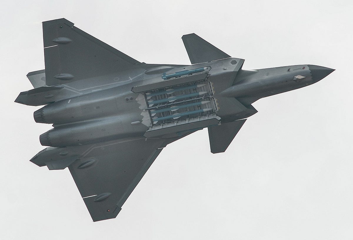

The second task is to replace the F/A-18E/F, and this is work from the deck of an aircraft carrier and strike operations with clusters of bombs hanging under the wings. The French also need a carrier-based fighter for a new aircraft carrier, which could help them join the alliance.
I'm quite sure that FAXX and SCAF will use internal weapons bays. They may also have "beast mode" options for carrying more bombs at the expense of less fuel.
