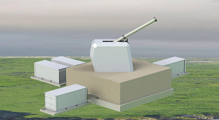

http://nextbigfuture.com/2016/05/shipping-containers-full-of-capacitors.html
