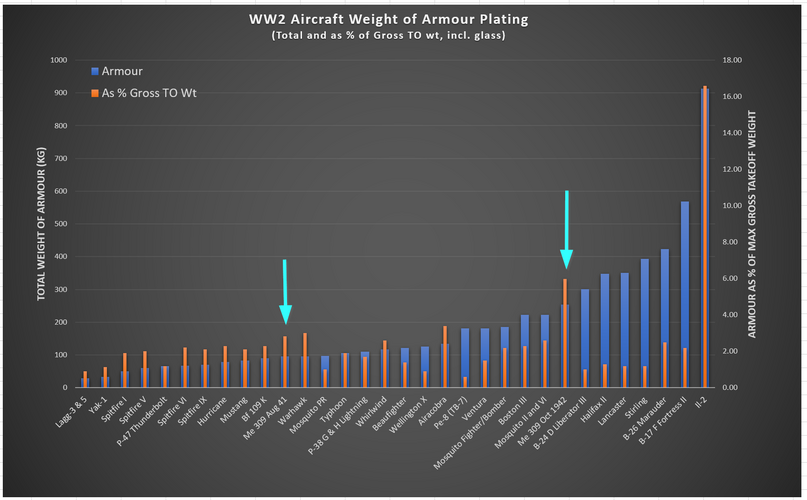

Take a look at the graph below (produced by Calum and for some reason not included in the book). The Me 309 was expected to carry nearly as much armour as a B-24 bomber. Imagine a production model Me 309 fitted with a DB 603 LA, 96kg of armour, fully developed retractable radiator (retractable for limited duration, with supplemental evaporative cooling) for an aerodynamically clean profile during combat. It still wouldn't have been able to out-turn a 109 but I would guess that, in terms of raw speed, it would definitely bring something extra.
But Willy Messerschmitt, having gone through the arguments between Augsburg and Regensburg over who would build the Me 309, believed there wasn't enough productive capacity available to establish production lines for a whole new type. Therefore, he made arrangements to create a fighter that could do the same job as the production model Me 309 but using as many existing 109 parts as possible - hence the 155 'normal fighter' and then 209. When the design of the latter was sufficiently mature, he briefed Galland on it and persuaded the Ministry to accept it as a replacement for the 309.
How much armour was the 209 expected to carry? 71kg. You can guess how that made its performance stats look compared to those of the Me 309 carrying 254kg of armour. Once a demand for extra armour has been made, it's difficult to get it rescinded. But starting again with a 'new' type, you can 'reset the clock' on how much armour it has.

Why did the Luftwaffe want 254 kg of armor on the Me-309? We're they trying to make it somewhat resistant to .50 caliber MG fire? That might help if they could reach the bombers but doing so would be harder with a notable performance penalty increasing time to get to altitude, and less of an ability to fight against the latest P-47 or P-51 escorts.
