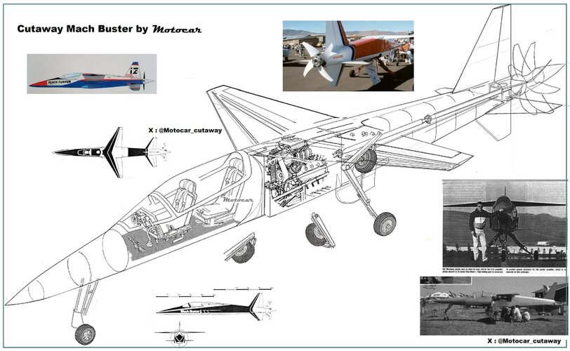

Greetings blairpilot and thanks for reminding me of this work in progress... I have it on my to-do list due to the lack of data on the landing gear kinematics and the lack of some digital tools that will help me finish it soon, for now I'll share how it's going...! Motocar
Post data is a purely speculative work

Greetings, I wanted to know if any friend of this topic could have information about the position of the engine in the fuselage of the Mach Buster, it turns out that the location where I initially placed it is the same space as the landing gear, being right in the center with folding retraction that has more space, for this reason I think that the V-8 engine would be placed further back... But this new location brings problems with the center of gravity, the fuel tank located in the center with the weight of the cabin forward to balance the weights...! I hope someone could help me with certain data even if it is a drawing facsimile. Thanks in advance. Motocar

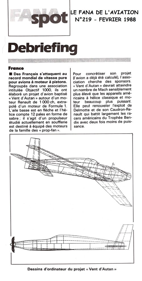

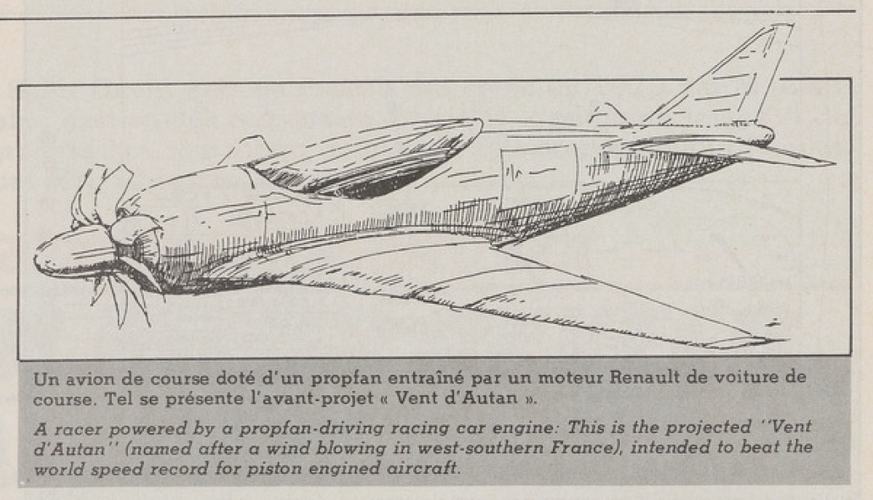

In another forum was this project, almost 40 years ago for a racer "1000 km/h" that had been studied in France with a propulsion by fast propeller : the Vent d'Autan ... I think he must have lost his way in the wind ...
The worst is that it must be me ! I had seen this project in the Fana at the time of the launch of this project. A superb view (Catia?) gave an idea of this Vent d'Autan that will never see the day (sigh ) ... The fast propeller was to be one of those tested in the program CHARME (Concept d'Hélice pour Avion Rapide en vue d'une. Meilleure Économie).
Not sure how I missed this, sorry!
I'd suspect battery and other ballast up front to keep the CG where you need it. It's easy to get a couple hundred pounds of weight in lead if you have to.
Thanks for the comment, I'll keep it in mind when remaking this Mach Buster cutaway. Motocar
Just to clarify: it was to be a Renault Sport engine, not plain Renault.
When Renault's sports car branch Alpine, located in Dieppe, proved non-profitable during the mid-1990s, it was rebranded Renault Sport, stopped producing original car designs, and was reassigned instead to the production of sports versions from existing Renault models: Clio V6, Mégane RS, Mégane Trophy, etc.
From a technical viewpoint, therefore, the engines were not the ones you would find in a regular Renault car, but specific, highly sportive types that were still Alpine except for the name.
It's only in the latter part of the 2010s that the Alpine name was revived and a new line of original designs started.

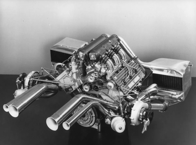

Absolutely ! It seems the projected engine was a Formula one adapted engine Renault.
Would have been some engine, Renault F1 engines of the day were pretty b sharp.
I remember that those engines had turbos that were nearly as big as the engine itself... And a service life of a few qualifying laps at max rated power.
But that max rated power was around 1000 hp for a 1.5 liter four cylinder engine. Pure insanity.
