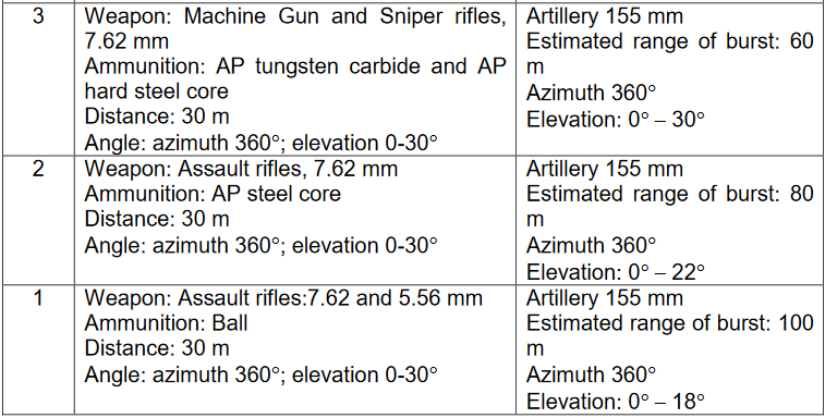

Optimal SPH protection level is Bradley equivalent. How Pzh 2000 avoids dying in Ukraine: it can survive ~20-30 meter 155mm bursts.

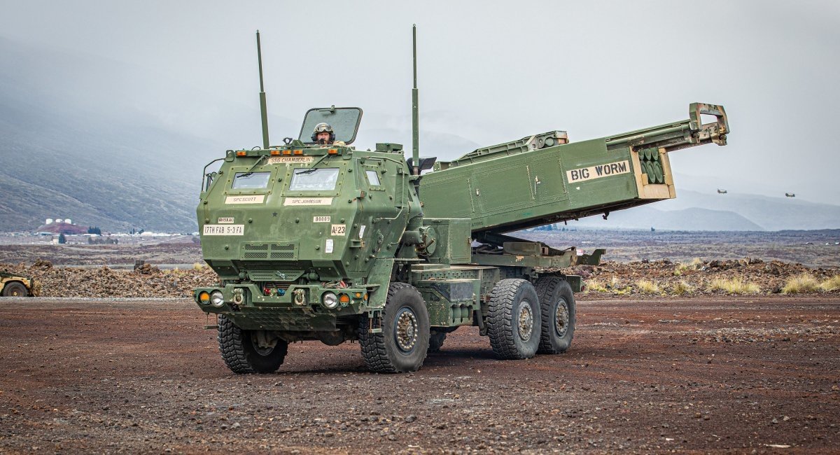

You'd just use GMLRS fired from a HIMARS or something if you're being shot at by long range artillery.
If the developers succeed during live firings, GMLRS will get real-time radio guidance. In addition to the ability to destroy stationary objects matching the target data pre-programmed before the launch, it will be able to strike moving targets as well.
The biggest advantage though is that such a guidance system will be much cheaper than all the alternatives. For example, at present, the most affordable guidance system against moving targets is laser homing. The rocket is equipped with a homing head, and someone has to "illuminate" the target with a laser beam: either a UAV with a pointer or a soldier on the site. Both variants presume that the target is not too far, and the laser beam operator risks getting caught in the rocket's collateral damage.
Even if it moves it can be hit with RIG-360 integration. There's a lot of redundancy (this is good) in the whole deal.
