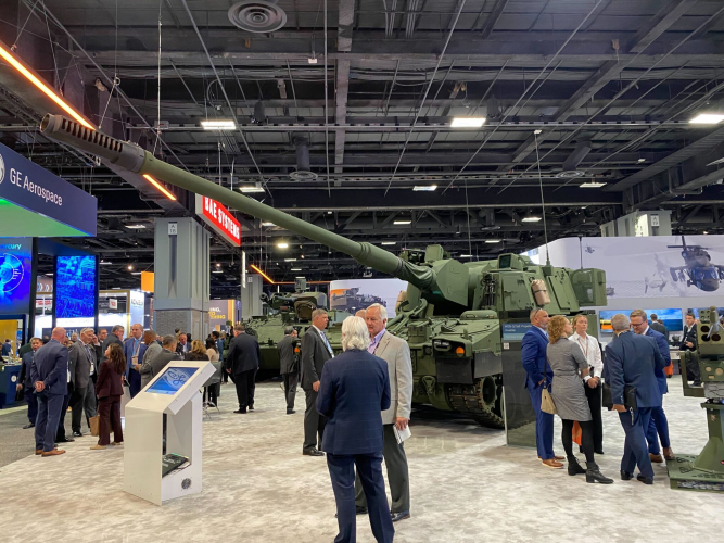

No explicit mention of the M109 with the proven Rheinmetall 52 caliber barrel tested at Camp Ripley, Minnesota and shown at AUSA last year, BAE Systems planned to conduct additional testing in 2024, with extended range and a variety of long range projectiles.
No explicit mention, but the RFI for an all-up system is stated as coming soon enough that prototypes can be tested *this summer.* That makes the BAE-Rheinmetall team happy because they already have the vehicle to test with. t
