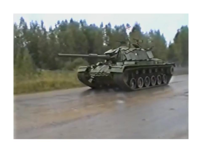

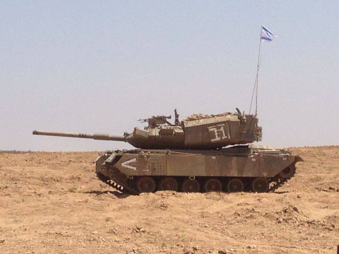

Israel did field the M60 ATGM tank, looked a lot like a normal M60.
Blending in with the rest of the tanks, is still a benefit, once your tank platoon is spotted.
Yes numbers matter, US/Nato seems to be standardising on fairly heavy tank, versus certainly Russian 'medium' weight tank.
To a journalist I guess?
If I see this thing my first thought is going to be "that's a command vehicle" or "that's a MCLC carrier" and I will immediately prioritize killing it with all available heavy weapons. It looks very different from actual Magachs, which look like this:
If you have trouble telling the difference between the two you need to be sent a remedial course for reconnaissance or you need to be booted from a position that requires identification of enemy armor and replaced by someone who can tell me "it looks like a command post or a breaching vehicle" on the radio. Better yet, someone who can identify this obscure AFV and say "it's a long range ATGW carrier". This isn't an unreasonable standard of training, it's the bare minimum needed to provide useful information, as in "this looks different from a gun tank so it's probably important" minimum.
There are always incredibly lazy or incredibly unmotivated people who will say "it's a tank" or "it's an APC" without identifying any obvious features, but they are just bad troops, the ones who will die or get people killed (and subsequently be killed) in a major war.
Large bustles are a dead giveaway that screams "I am very important please kill me" which is why actual command tanks look like this:

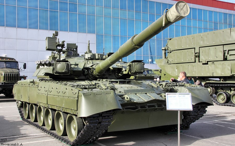

It looks nearly identical to a T-80U except that it has about three or four more radio antenna mounts. There's also a low profile TIS. The T-80UK is also a terrible command post vehicle though because it has so many extra antennae that it's an easy target to distinguish in close combat! The M1 Battle Command Vehicle is literally identical to the M1A1(HA) externally, with the exception of radio antennae being slightly more, but not as many as the T-80UK IIRC.
The point is that a command vehicle should be absolutely, utterly, and totally indistinguishable visually from a normal gun tank externally, from all angles except maybe the top, and you should minimize the number of radio antennae and protrusions that give away the command tank's true purpose. This is relatively simple with low profile, flush mount SATCOM like Starlink nowadays I guess. Much harder if you need a lot of whip antennae but you can cover gun tanks in those just as well with stuff like the DUKE/CREW jammers and Shortstop.
This is why the original M2 MBCOTM was awful:
Highly visible SATCOM and datalink antennae make it an easy target during an assault because that just screams "I am very important please kill me" and a gunner who is not being taken under fire, or a decently trained gunner, might aim explicitly for that. Which is why it was only used by brigade and division commanders like GEN Odierno.
Which your example of Pereh does not in the slightest. That's probably why the Israelis kept them hidden behind hills and buildings!
Even then the lowest level of T-80UK was supposed to be company I think. A platoon almost certainly doesn't require the extra radio muscle a command tank provides.
