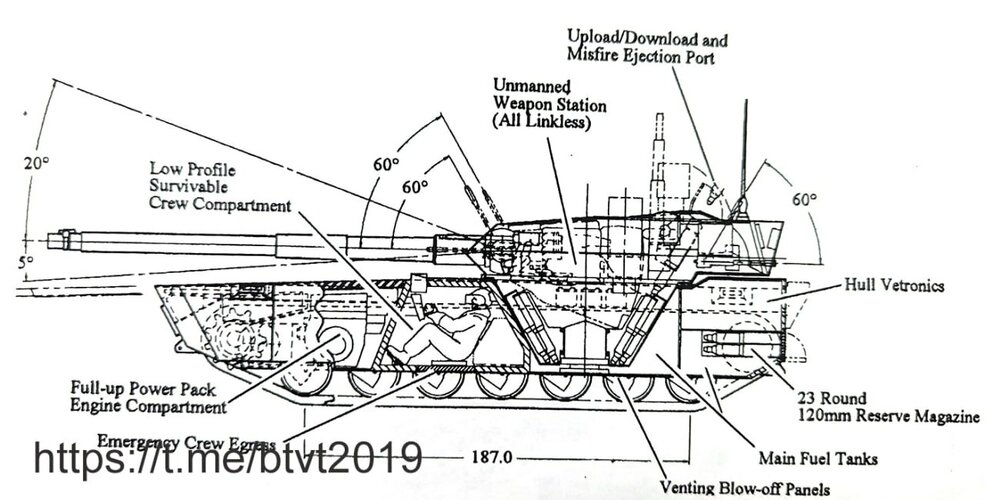

And in the '80s the M1 CATTB was fitted with a 1450hp Cummins XAV-28 V-12 diesel, but that thing was hella weird and used the same oil for cooling and lubrication.
That actually struck me as a really clever idea. Not least because your oil temps are going to be about 400degF and mean you can use a physically smaller radiator that is more tolerant of small holes in it.

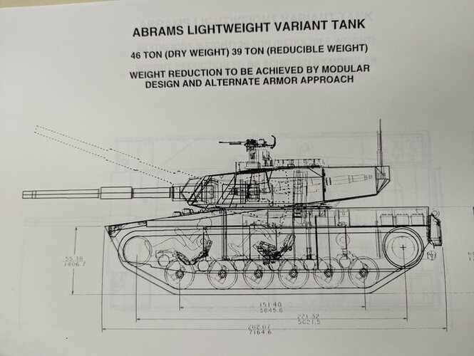

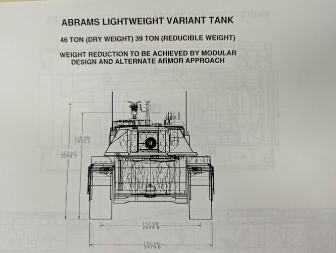

Thirty years ago General Dynamics introduced a lightweight Abrams programme. Many of its elements are used in the current, "new" Abrams X and M10 MPF.
The US Army is still searching for forgotten gold in the junk heap of yesteryear FvXJmoaacAQCxNc.jpg

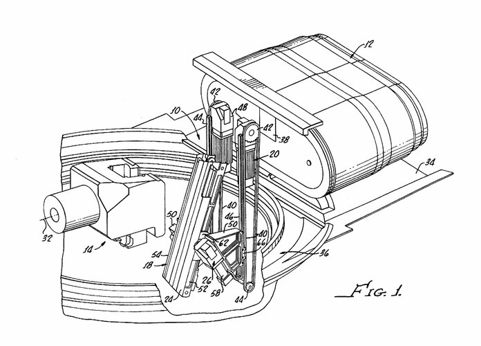

A future M1 could get away with a single belt/ribbon autoloader of 24 rounds with two natures of ammo: sabot and high explosive/AMP and not be too worried about ammunition use I think. This would definitely free up more space for armor or fuel or whatever.
The US Army is still searching for forgotten gold in the junk heap of yesteryear.

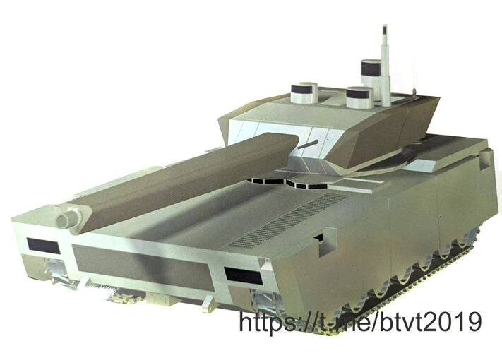

Future Main Battle Tank Western Design Corporation.

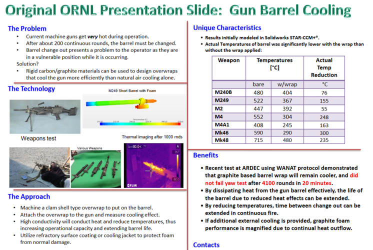

Tank machine guns will need to go back to water (steam) cooling or have built-in swappable barrels like the Rheinmetal RMG 7.62.
Nothing inherently wrong with that, not like a tank is going to notice 5 gallons of water.
It's a little less than a quart.
The prototype M240B's steam jacket was scarcely larger than an integrated silencer. It's far more elegant than the primitive RMG 7.62 system of a mechanical barrel swap, but the method of superheated steam/phase change cooling is not very interesting, at least until you get into quintuple digits of machine gun ammunition.
4,100 rounds over 20 minutes is nothing to sneeze at and comparable to expenditures of ammunition in some medium-intensity close combat cases. Wanat, Chechnya/Grozny, and some battles in Vietnam come to mind immediately, but that's specifically based on the first one.
However, tanks usually don't carry that much ammunition in the first place (the M1 is somewhat unique in carrying >10,000 rounds of coaxial ammunition; the Pattons only had like 7,000 rounds of .30 cal, which is still double European vehicles like Leopard 2 and Challenger) and the PCB jacket's designer was envisioning something like a robotic combat vehicle with 10-20,000 rounds of onboard ammunition in a single massive magazine.
So no, neither the tank, nor the infantryman, would notice it. The hard part is, obviously, finding a use for that sort of cooling capacity. That's a lot of ammunition and barrels add fairly little excess mass relative to their heat capacity already, so simply carrying a couple barrels for every box of ammo and finding a rain puddle is what is normally done.
This only makes sense in the case of a high density robotic or computer-aided machine gun where the mass of tens of thousands of rounds of ammunition is accounted for. So a tank (or RCV) coaxial is just about the only place where it's useful. Aircraft already have high air speeds working in their favor and dismounted combat troops can just lug more barrels. Tank crews are sort of stuck.
However, tanks usually don't carry that much ammunition in the first place (the M1 is somewhat unique in carrying >10,000 rounds of coaxial ammunition; the Pattons only had like 7,000 rounds of .30 cal) and the PCB jacket's designer was envisioning something like a robotic combat vehicle with 10-20,000 rounds of onboard ammunition in a single massive magazine.

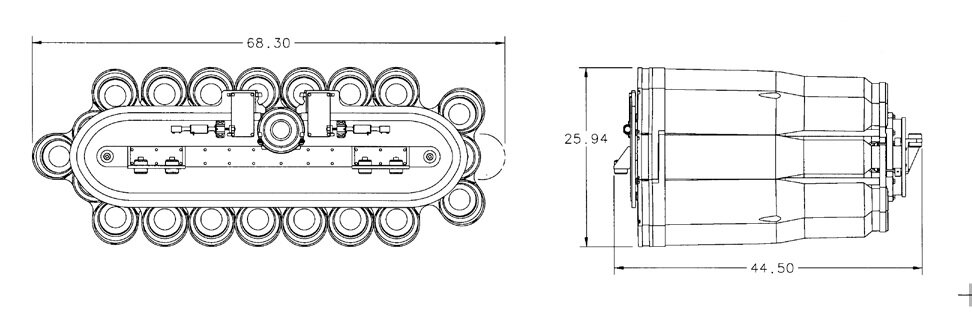

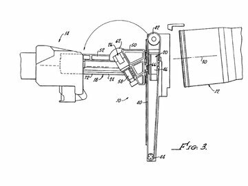

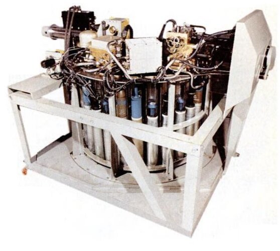

By the way, in fact, apart from the XM91/M1X-based tailpipe autoloader. The US Army was actually testing a "thunderbolt" based on the XM8 AAM system as late as 2004. It is equipped with 18+1 rounds and is used with the XM291 120mm gun. Rate of fire 12 rounds per minute
IT first shown in 2003 AUSA

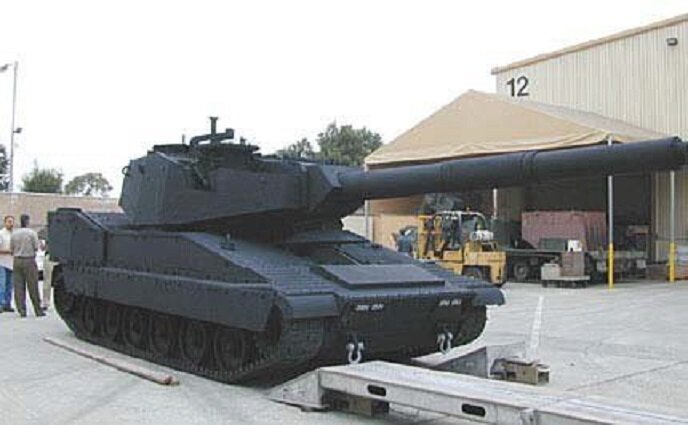

Ah, that's another reason why the MPF went with 105mm. M8 AGS with the 105 held 31. That's a pretty severe loss of stored kills, and it's about 2 less than the usual NTC course of fire.
And personally, I prefer the M1TTB autoloader/unmanned turret. Too bad it's in really rough shape right now, but it is on the list to be cleaned up and restored at the US Army Tank Collection.
Thunderbolt was a United Defense thing not a U.S. Army thing. The U.S. Army lost interest in M8 in 1998. Thunderbolt tested a hybrid-electric drive (for the FCS program, no less). Lightning Bolt tested the electro-thermal chemical ETIPPS generator/capacitor bank in a modified bustle rack. The most interest the U.S. Army had in M8 after the bid failed was the driver's hatch, which was similar to the one eventually used on the FCS MGV, in all seriousness.
That itself might just be UD's common design philosophy though. The FCS tankettes owed a lot of their general layout to M8.
Stored kills also aren't really important outside of shooting ranges, honestly. MPF went with 105mm because its purpose is to act as a MGS for IBCTs. There's plenty of 105mm HEP sitting around. There's barely any AMP rounds, much less HEAT-MP, though. That's about the only reason.
Killing tanks is something it would be uniquely bad at. Tanks are why the Infantry have the TOW and Javelin.

Friend of mine was in Strykers for Afghanistan 2010, IIRC. He said that the GDLS had a whole company of engineers at one or more bases in country, trying to keep the MGS loader working, but never managed to do so.
Yeah I think the issue was three fold: the carousel's bins were improperly sized for the 105mm (not enough support at the lower end) which caused the shells to jiggle, the floor plate of the turret (or magazine) was too thin and jammed up, and the rim grabber would extract shells without a proper grip.
Put together that means that the shells would slide into position either too far or too short, then be at a bad angle, and get grabbed by the grabber. It would retract on its little racetrack back to the bustle of the turret where the rammer lives, but the shell ends up getting caught somewhere in the track because the grabber has a poor grip on it, or get caught during the ejection cycle in less common cases.
So you had to disassemble the whole thing when this happened, by removing the turret, and it happened a lot. Usually occurred if the wagon was mobile when reloading or if the turret was rotating AIUI.
That's how it was explained to be in a phone call anyway.
GDLS and the Army both knew what was up but GDLS was asking way more than the Army's engineers at Benet or Picatinny thought it was worth to fix their own mistakes then the new V-hull Strykers made it irrelevant anyway.
